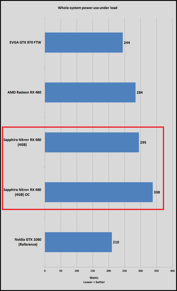

MSI Gaming X 1060 vs Sapphire Nitro+ RX 480
4GB model
8GB model
Overclock Comparison
4.8% (RX 480) vs 8.0% (GTX 1060). 4GB model still draws an extra 85W under load, 100W for the 8GB model.

17,886
Really curious to see how mobile chips end up, since within 35-60W limits any significant power advantage turns into pure performance advantage, and by the looks of it Nvidia chips will maintain at least some advantage even there.
