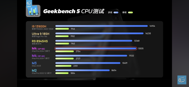

Much of what Twisted Andy says makes sense in that the end user does not care about benchmarks but performance in applications.
As for those tests that are included well it’s to test CPU performance and only that and if they applicable to you that’s great.
Benchmarks give us an idea of a CPU performs, that’s their function.
But what is really funny is that Apple never uses Geekbench, SPEC or Cinebench to showcase any CPU improvement in their testing. Intel, AMD, Qualcomm, MediaTek do in their keynotes to hype or either manipulate.
Let’s take an example of Apple’s last keynote and look at what they claimed regarding M4 performance improvement. They said M4 has up to 50% faster multi-threaded performance than M2 in the Affinity Photo 2 using the built in benchmark. They mention up to 50% because there’s various versions of M4.
Now let’s see if that up to 50% multithreaded claim holds up in Geekbench 5.
what do you know?? It does. Of course, this makes sense to compare because Geekbench 5 MT scales well. That’s why use the right benchmark that suits your needs.

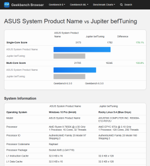

By the way, I find it really difficult to understand how some can prefer Cibenench to Geekbench as a general-purpose benchmark.
According to Geekbench, 16-core AMD Ryzen 9 7950X is 32% faster in the multi-core test than AMD EPYC 9754 with 128 cores:
Again. 16 cores are faster than 128 cores using the same architecture. Does it match the reality?
I have been saying for months that the only GB6 test that seems to scale is Ray Tracer. Here we see that 7950x scales by about 19, while 9754 scales by 108.
