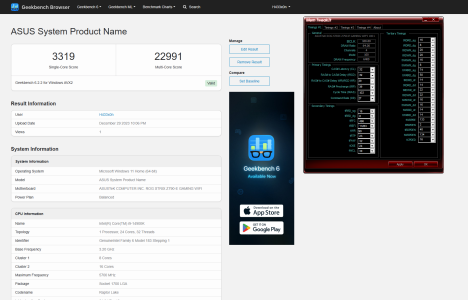

Downloaded Geekbench 6 today and this is the results I got.
The most interesting result is below:
System is not overclocked, I downclocked my ram from DDR5-6800 to DDR5-6400 to match what I was running with my old 13900K with same timings. This is the same system that I ran my 13900K in, so it's truly apples/apples. The 14900K has PL2=241W and IccMax=360A, so it's got less power than the 13900K (PL2=253W & IccMax=512A) had to work with.

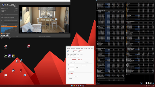

I traded one of my 7950X3D's for this SP119 7950X with a fellow forum user from overclock.net, without any money involved.
Its a good sample but not anything super special.. (IMC could be better)
LLC 5, L3 idle temp ~20 degrees, max load ~60 temp (~185w PPT with 6000/2000 memory)
1200mv vcore set, ~1110mv get under load
Maximum stable 3x in a row Cinebench r23 allcore clocks:
7950x SP 115 (SP 120 + SP 110) = 5400/5300mhz -> 2233 PGE
7950x SP 117 (SP 121 + SP 112) = 5500/5200mhz (6200/2200) (insane CCD0, very bad CCD1)->BQ 2231 PGE
7950x SP 116 (SP 119 + SP 114) = 5450/5350mhz (6200/2100) ->2232 PGY
7950x SP 116 (SP 120 + SP 111) = 5425/5325mhz -> 2233PGE
7950x SP 115 (SP 119 + SP 110) = 5425/5275mhz (6400 maybe 6600 / 2200 -> 2240 SUY
7950x SP 114 (SP 121 + SP 108) = 5450/5250mhz with L0 cache error ->2241 SUY
7950x SP 116 (SP 119 + SP 112) = 5525/5350mhz (6600/2200) ->BQ 2239 SUY
7950x SP 117 (SP 119 + SP 115) = 5350/5275mhz (6600/2200) ->BQ 2333 SUE
7950x SP 119 (SP 120 + SP 118) = 5375/5425mhz (6600/2200) ->BQ 2245 SUY (delidded with direct die cooling)
7950x SP 116 (SP 119 + SP 112) = 5550/5200mhz (6600/2200) ->BQ 2252 SUY
Would actually say my 7800X3D and 7950X3D are better silicon quality (i'm the one with Norwegian flag)

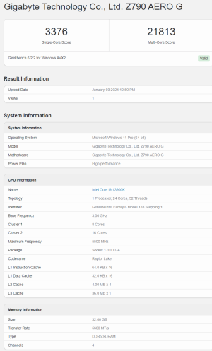

This is my undervolted 13900K at 60x single-core and 55x multi-core using 5600 MT CR1:
Side-note: very few parts of GB6 trigger the AVX offset, something to keep in mind when comparing numbers. I disabled the AVX offset for the above result for easier comparison, but usually use a -1 offset that affects single-core load and affects 2 out of 8 P cores for all-core load.

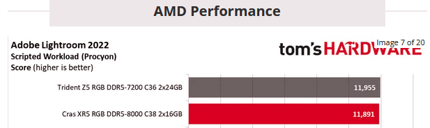

For now, some tests 6800 MT/s CL34 → 8000 MT/s CL38 (Tom's Hardware). Cherry-picking some results where we see improvements, as some workloads like Office, Cinebench, etc. didn't budge or went the other direction (!).
That is, even if Topaz doesn't show a measurable difference, there should be some improvement that can get teased out in other "real-world" applications:
+4.89% in PhotoShop
+2.17% in Lightroom
+6.66% in Far Cry 6
I'm not saying these are representative; I just mean to share that it could be perhaps Topaz or methodology, as RAM speed should improve some "real-world" applications somewhat, too.
Representative of Tom's Hardware's full suite, there is some improvement to be had. I'd say margin of error, but it appears the slowest memories have the lowest scores in this geomean of some two dozen tests.
+2.4% in geomean of entire suite
^^ not ideal as this suite includes lots of synthetics, including a RAM bandwidth test (!)
Thus I'd say GB6 could be a little more memory sensitive than most applications, but not by a significant absolute sense (+2-3% more?).

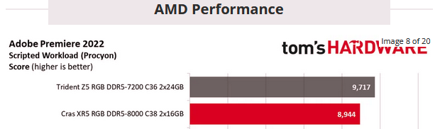

Very anomalous result from the only 48GB kit. Guess the higher density memory chips can be quite advantageous in certain workloads.
That is interesting, a +9.7% improvement . I've learned UL Procyon's test is a pure export (i.e., render) test, so no edit-based benchmarks (like Puget does). I don't have this test and neither do many, it seems.
In general with Premiere Pro, some found faster exports with more RAM, others not so much. Premiere Pro seems to increase its RAM usage during export if you have more RAM, even if you weren't close to your physical limit, e.g,. 17GB usage on a 32GB system to 21GB usage on a 64GB system.
  1. 32GB to 64GB: ~9% improvement with a 4K, 100 Mbps source file: 687s on 32GB, 631s on 64GB
  2. 16GB to 32GB: ~12% improvement with a 4K export to 40 Mbps: 850s on 16GB, 726s on 32GB
Maybe based on the bitrates & total file sizes (unsure if source or destination is more important)?

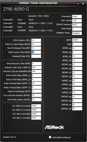

Ain't these all XMP based comparisons? And concerning Geekbench testing, I only did my own tests of tuned 5600 CR1 vs. higher MT at equal to lower total timings (in nanoseconds). I did not save results, though, as I was only interested to see for myself how memory OC affects GB results, which it does. It's more than just 0.something % from what I remember.
My 5600 MT peak at about 94 gb/s read-rate. Of all the primary, secondary and tertiary memory timings the following are at their minimum and thus their latency could only be improved upon by using higher MT.
CR 1T, RDRD_DG 8T, WRWR_DG 8T
I am not sure if RDD_L/S is at a minimum at 4T or if lower values can be used on Intel, same goes for FAW at 16T.
All other timings can just be set to lower values for pure timing/latency improvements without needing to increase MT. BUT, some of those timings need higher voltages to stabilize at lower values, which in turn can then just as well be used to increase MT along the way (if voltage is already increased for timings anyway).

Hynix M-die (2x 16 GB) running 5600 MT at 1.20 V (was 1.15 V before one of the earlier BIOS updates, RDWR was 18 T before one of the later BIOS updates). I consider some of these timings "meme timings" meant to keep the angry "you are castrating your 13900K" crowd away from their torches and forks.

It's noteworthy that going above CR 1T doesn't work easily (or maybe at all) above 5600 MT even using considerably higher voltage. RP/RCD (coupled on Gigabyte) need 1.35 V for 12.0 ns while I am using 1.20 V for 12.5 ns here, but CR 1T doesn't even work at 5800 MT using 1.35 V.
So 5600 MT seems like a sweet spot. Also comes at the benefit of being basically JEDEC from the IMC's point of view, so 1.10 - 1.15 V VDD2 is enough for the timings shown in my screenshot. Since my IMC/board (6 layer PCB, GB Z790 Aero) refuses to run VT3 stable 6800 MT with similar timings (in ns) I suspect that my IMC isn't too great (and my 13900K is about average for core clocks).
Concerning Geekbench, I suspect it mostly likes memory bandwidth.

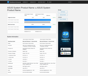

Comparison of some Ryzen top CPUs with the lone Core i9-14900KS result on Geekbench browser:
Geekbench really needs to capture more differences in configuration, like the speed/latency of RAM so we can figure out why the same CPU is showing wildly different performance results in different subtests.
