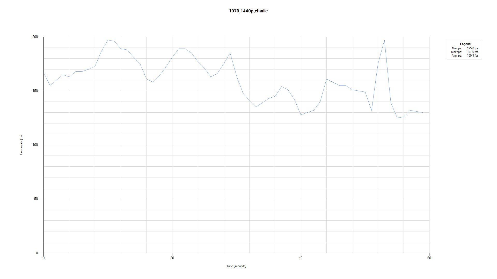

Here is how your results look.
You have the same frametime variance as I do, but your performance is a lot better overall.
I don't have a cpu limit, gpu usage is maxed out, let's not go there again, haha.
The gtx 1070 is a bomb, that's all. If I had a 1070 I would probably not get the same performance as you, but that's a different thing altogether.

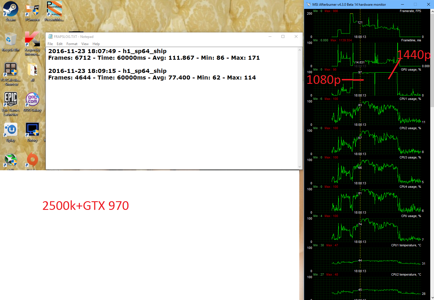

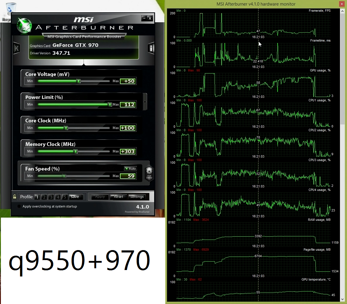

My friend Head1985, thank you for these comparisons, but I believe we have a major misunderstanding here.
In all the 2500K screenshots and videos you posted, the GPU usage is not maxed out. Far from it.
What I have said many times, is that if the GPU usage is 100% on the 2500k, you will NOT get better performance on the 6700K.
The actual reason you are getting better performance on the 6700k, is because your GPU usage was not maxed out on the 2500k. This is what a cpu limit is. The GPU not being able to max out.
Now coming to where all this discussion started, my GPU usage, in the charlie don't surf 60sec benchmark I asked you to run, is maxed out.
See the gpu usage in 1080p and 1440p. Cpu is at 4.3Ghz not even 4.8Ghz and the GTX 970@1500
I know the cpu usage is also very high, but it is not giving any cpu limit. It is just very high. Probably if I install a better graphics card, I will not be able to max it out. But it is OK for the 970.
And here is the benchmark result you see in the picture in text.
2016-11-23 18:07:49 - h1_sp64_ship 1080p
Frames: 6712 - Time: 60000ms - Avg: 111.867 - Min: 86 - Max: 171
2016-11-23 18:09:15 - h1_sp64_ship 1440p
Frames: 4644 - Time: 60000ms - Avg: 77.400 - Min: 62 - Max: 114
The reason you are getting 160fps average on 1440p, is because the 1070 is indeed THAT much faster in that specific scene. That's all there is to it. No cpu limit from my 2500k in this specific test.
Again, I am not saying the 6700k can offer no benefit. It offers no benefit when the GPU usage was maxed on the previous processor. In your examples it was NOT!

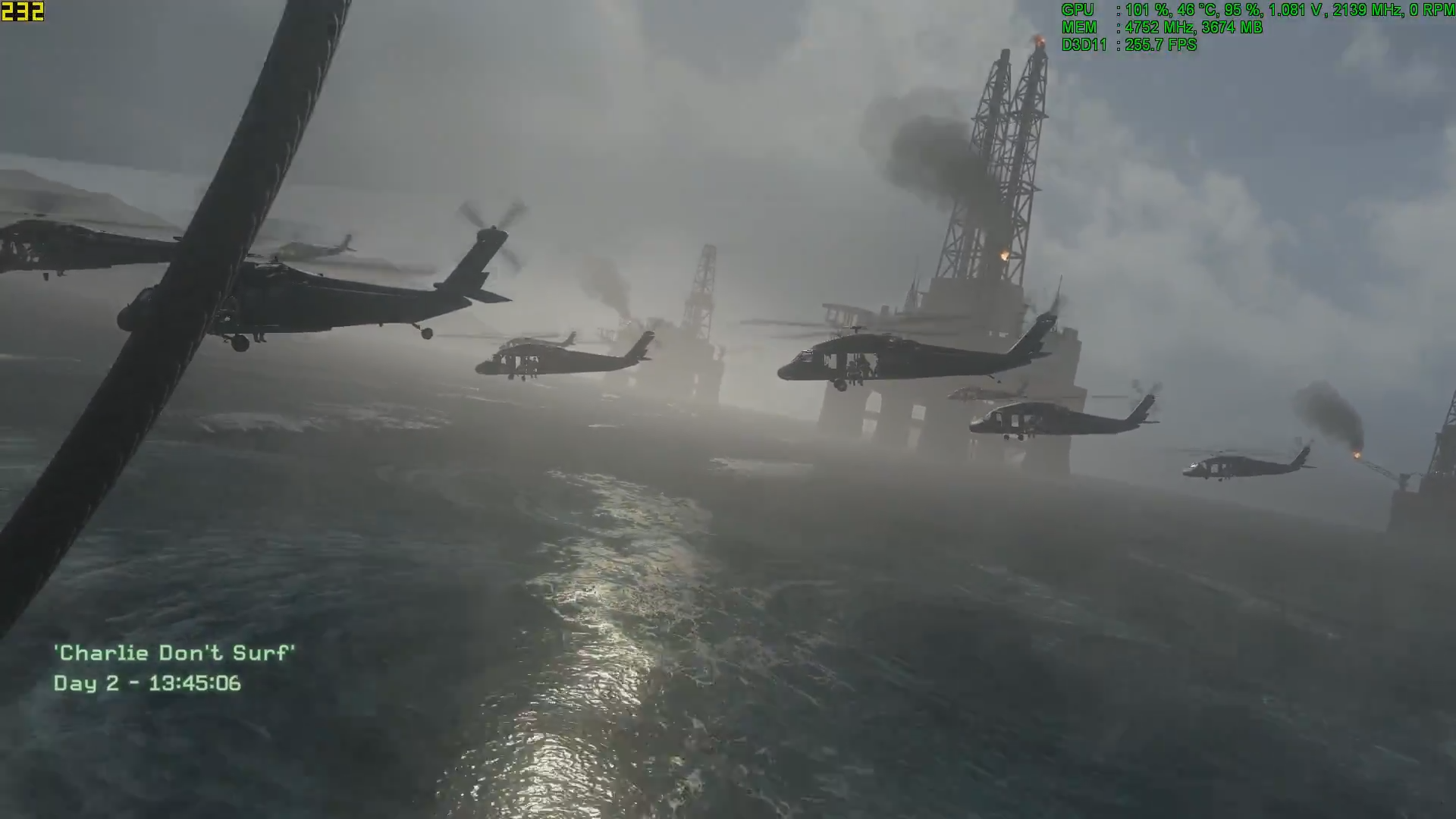

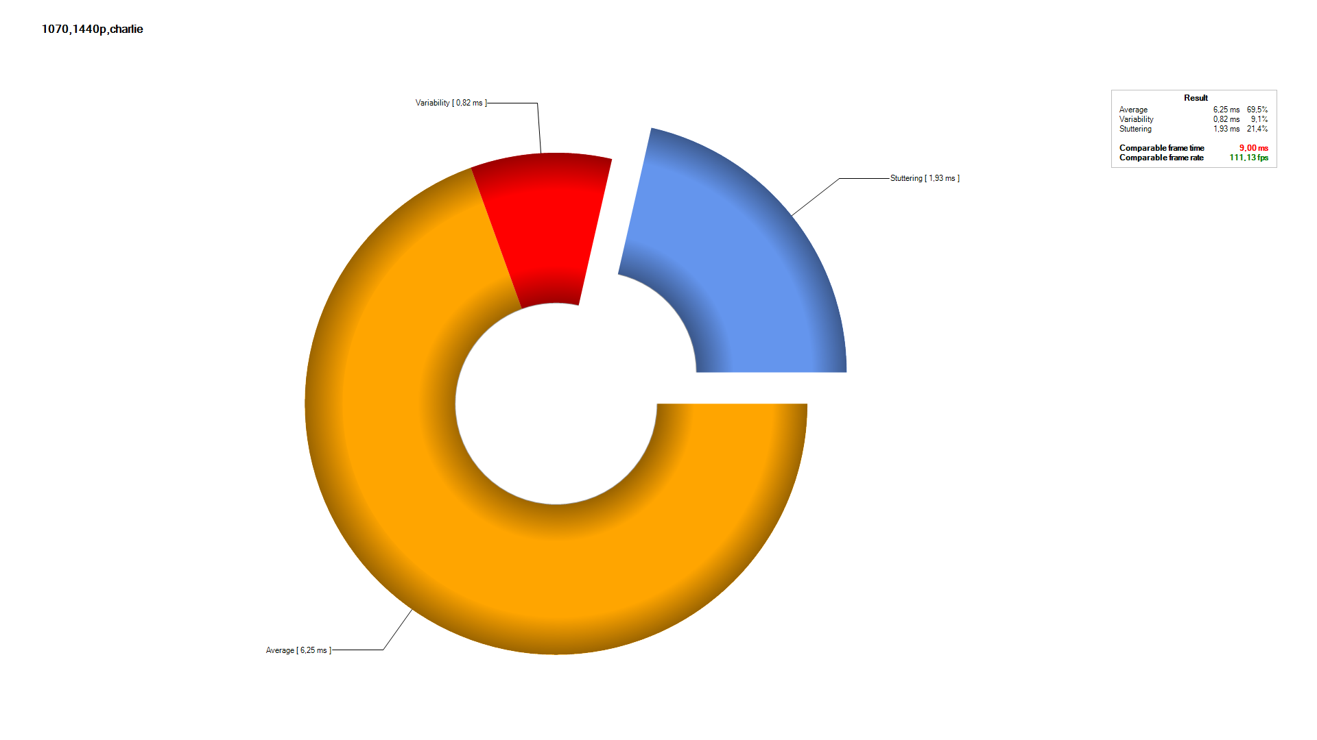

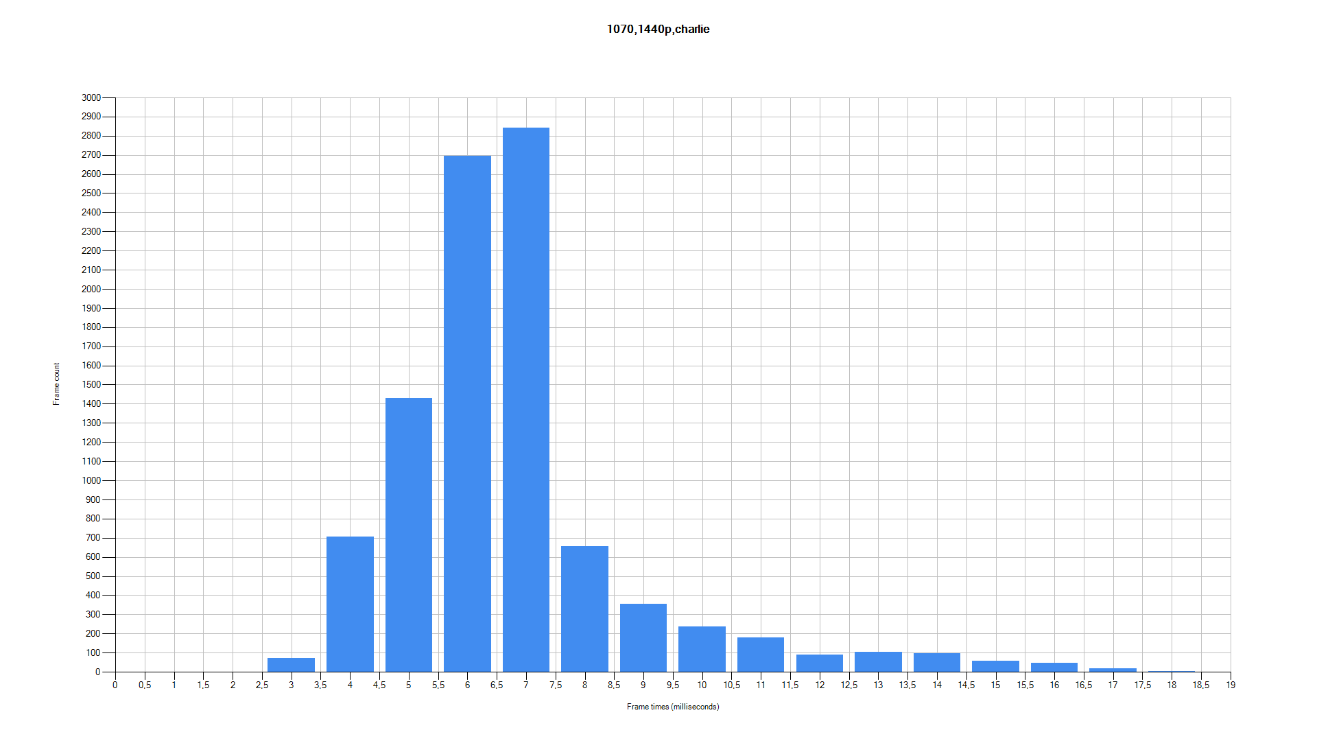

Hey psolord i know you already testing GTX1070.I tested that charlie dont surf mission 60s in 1080p.From avg and comparable FPS its 2x faster than your gtx 970.Can you test that with your GTX1070?We will see how much cpu bottleneck you have.
http://www.edisk.eu/download/60648/benchmarks.rar_68.42kb.html/
btw i am pretty bad cpu bottleneck in 1080p with 6700k 4.5Ghz.I watched your video and i have 30-80 more fps in that scene so you must be even more cpu bottleneck.
Edit my own video recorded with shadowplay(so 10%performance hit) as you can see in some scenes i have 50% more fps.And we both have GTX1070.We should have same performance.

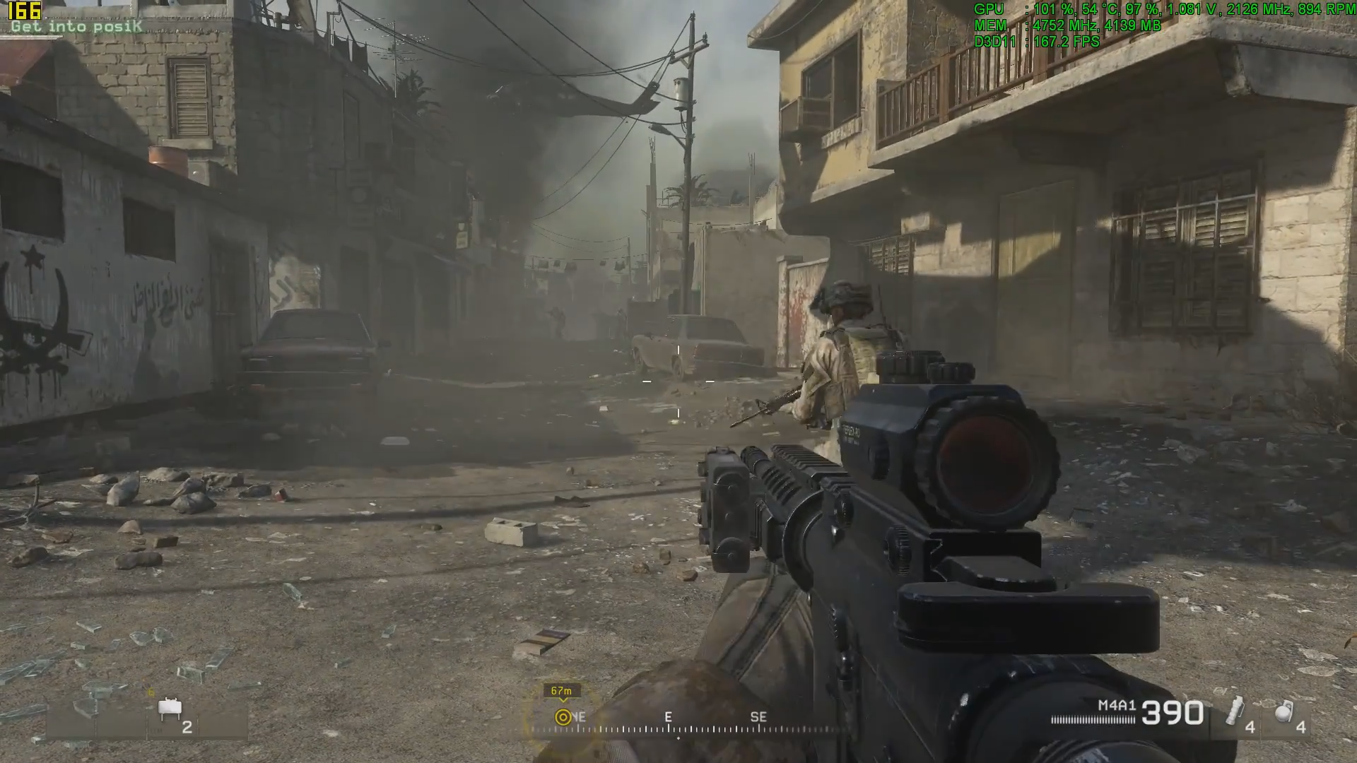

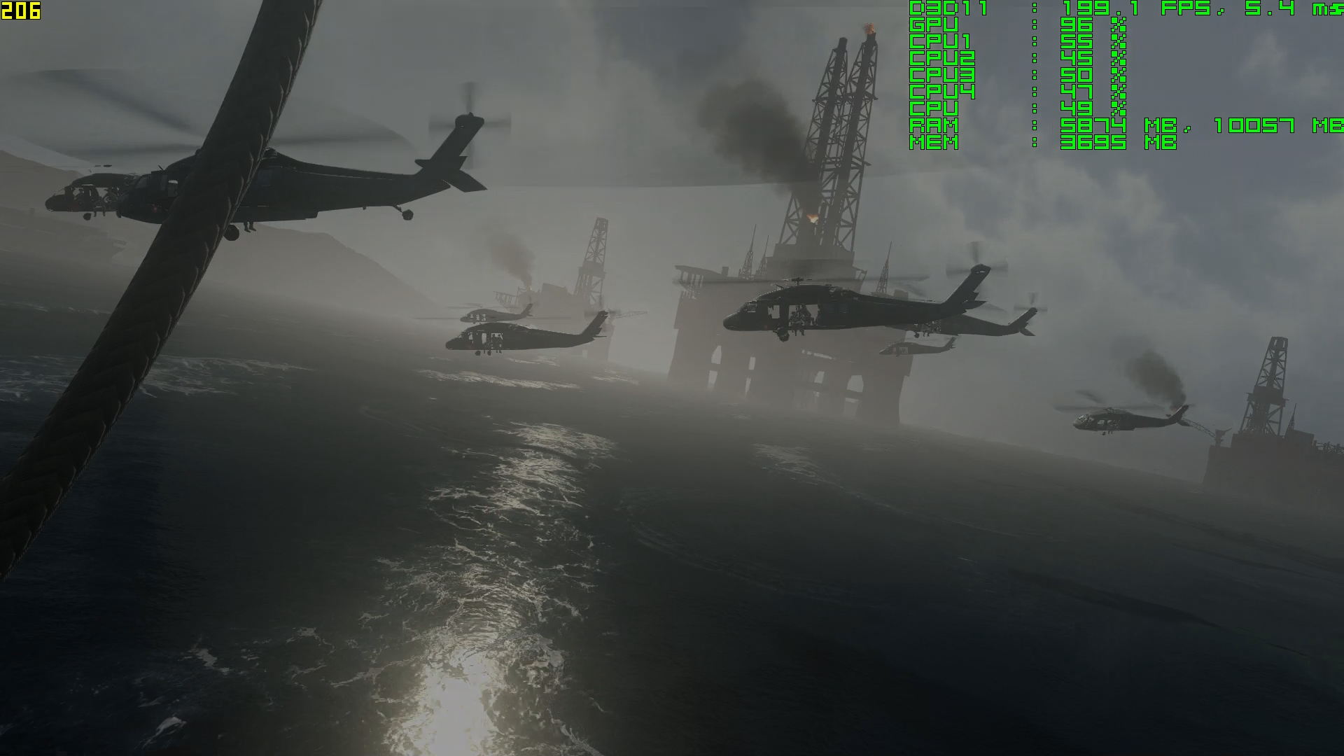

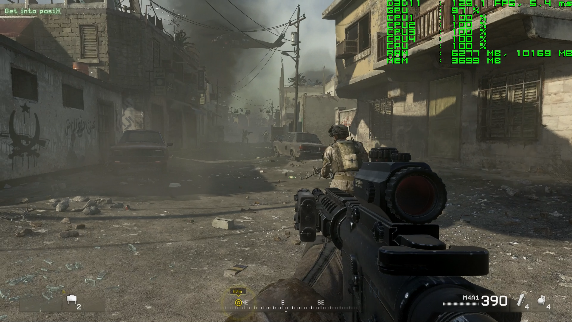

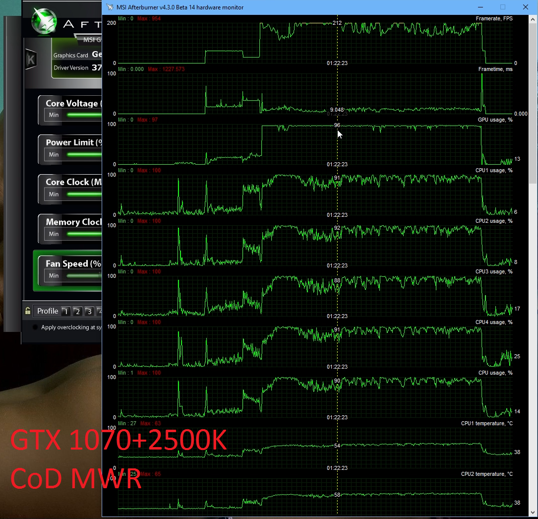

Your system is getting better performance for sure. There's not denying that. Here are two screenshots from our videos at the same places for easier comparison.
Now as you can see, especially for the screenshot where the soldier lands, we can clearly see that we have the same gpu load at 97%, yet the performance on the 6700K is considerably better. In my book that's just wrong. This is not supposed to happen.
A clear cpu limit makes the gpu usage having lots of dips and being very jagged, like so (from my Dying Light Q9550+970 benchmark, which was severely cpu limited).
Now in both my Modern Warfare Remastered runs, the gpu usage was like so.
I know it's not optimal, but if both our systems show 97% gpu usage, that does not explain the 25-30% framerate difference.
I will send Unwinder a question as to why this happens and hopefully he can explain it somehow.
I do fear however that my bottleneck may not be the cpu itself, but the PCI Express, since I only have PCI express 2.0.
Still I will stop worrying about it too much. Talking about cpu limits at 100 and 200 fps is kinda moot.

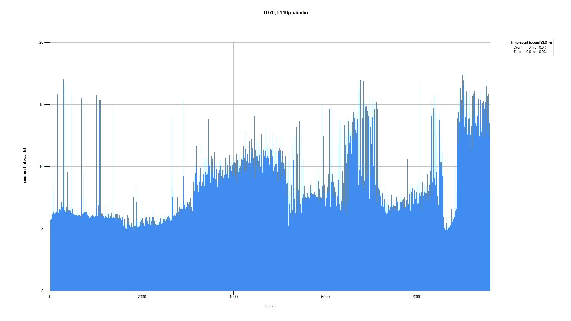

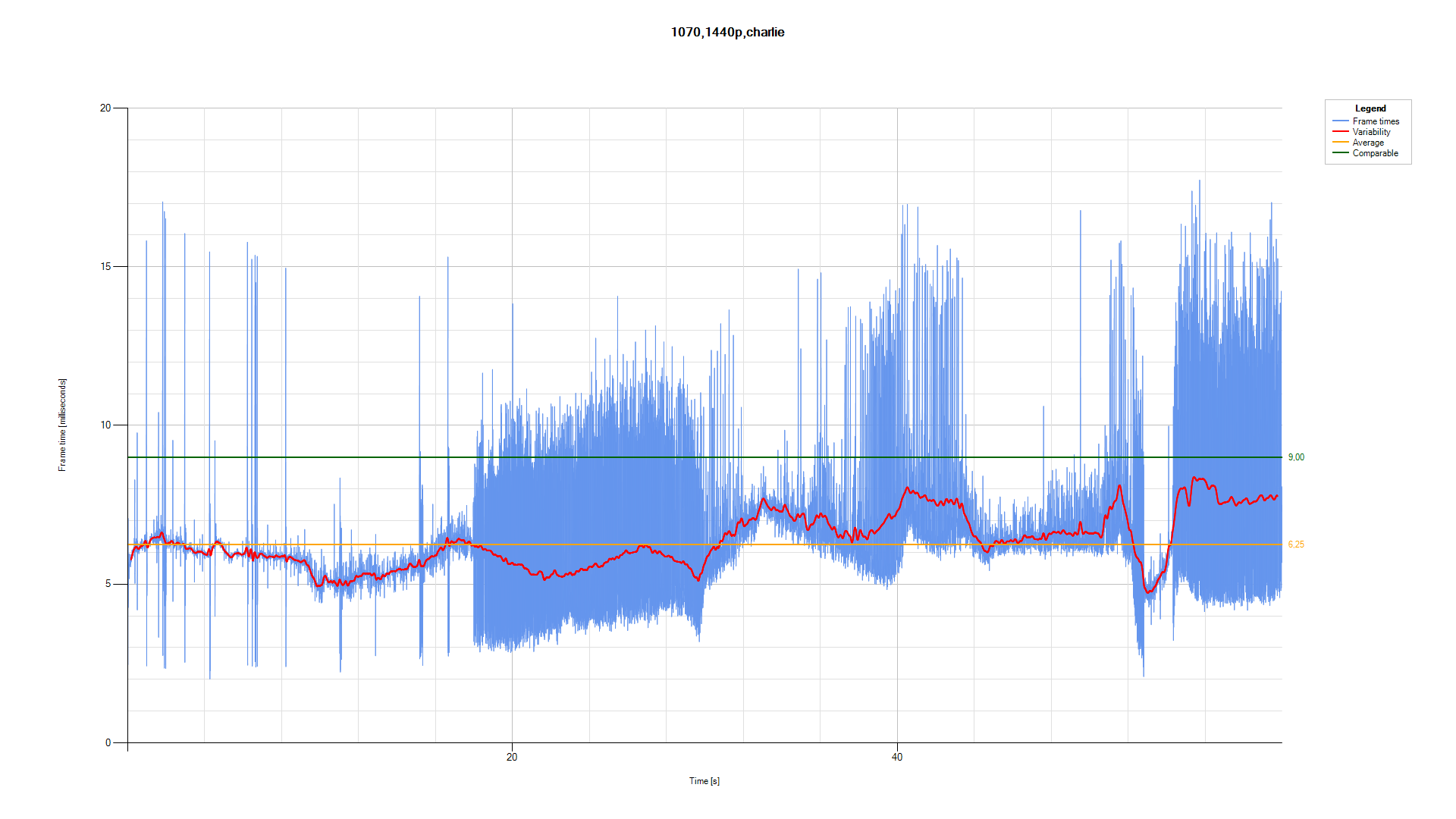

psolord
Sep 16, 2009
2,125
1,256
That is really good and actually I do like it, because I am gathering more data! :)
Now time for some more testing, since I need to align all this data.
Can you post CPUz, Cinebench R15 and Geekbench 4 results with the 6700k@3Ghz with no HT? At your convenience, no harry.
And yes guys, this has to do with Modern Warfare remastered! :D
Head1985
Jul 8, 2014
1,867
699
geekbench4
https://browser.geekbench.com/v4/cpu/1200893
CPUz
CB
psolord
Sep 16, 2009
2,125
1,256
Hello again my friends. Head1985 thanks for your quick reply and sorry for the late reply of mine.
Here are my respective tests of the 2500k @ 4.8Ghz.
https://browser.geekbench.com/v4/cpu/1258531
To recap, my GTX 1070 and 2500k @ 4.8Ghz gave us
2016-11-24 22:52:33 - h1_sp64_ship charlie 1080
Frames: 8756 - Time: 60000ms - Avg: 145.933 - Min: 102 - Max: 230
while your 1070 and 6700k at 3GHz no HT gave us
2016-11-29 22:40:09 - h1_sp64_ship 1080p
Frames: 10382 - Time: 60000ms - Avg: 173.033 - Min: 95 - Max: 279
So, although in terms of raw cpu power a 2500k@4.8Ghz is faster than a 6700k@3Ghz without HT, the 6700k was still faster in the charlie-dont-surf-ometron.
This alone, makes me believe that the 2500k is not cpu limited with the classic meaning of the expression, but there is something deeper at play.
Without knowing any better, I still believe that it's my PCI Express 2.0 that is the culprit here and that, not in terms of raw bandwidth, but maybe in terms of IOPS or overhead or something.
My chipset being a really old P67 may not be helping either, but the PCI express controller responsible for the graphics cards, is embedded into the cpu since the Sandy Bridge, so this may be irrelevant.
I now have enough data to take the discussion to more knowledgeable people than me, so thank you for your feedback mate.
