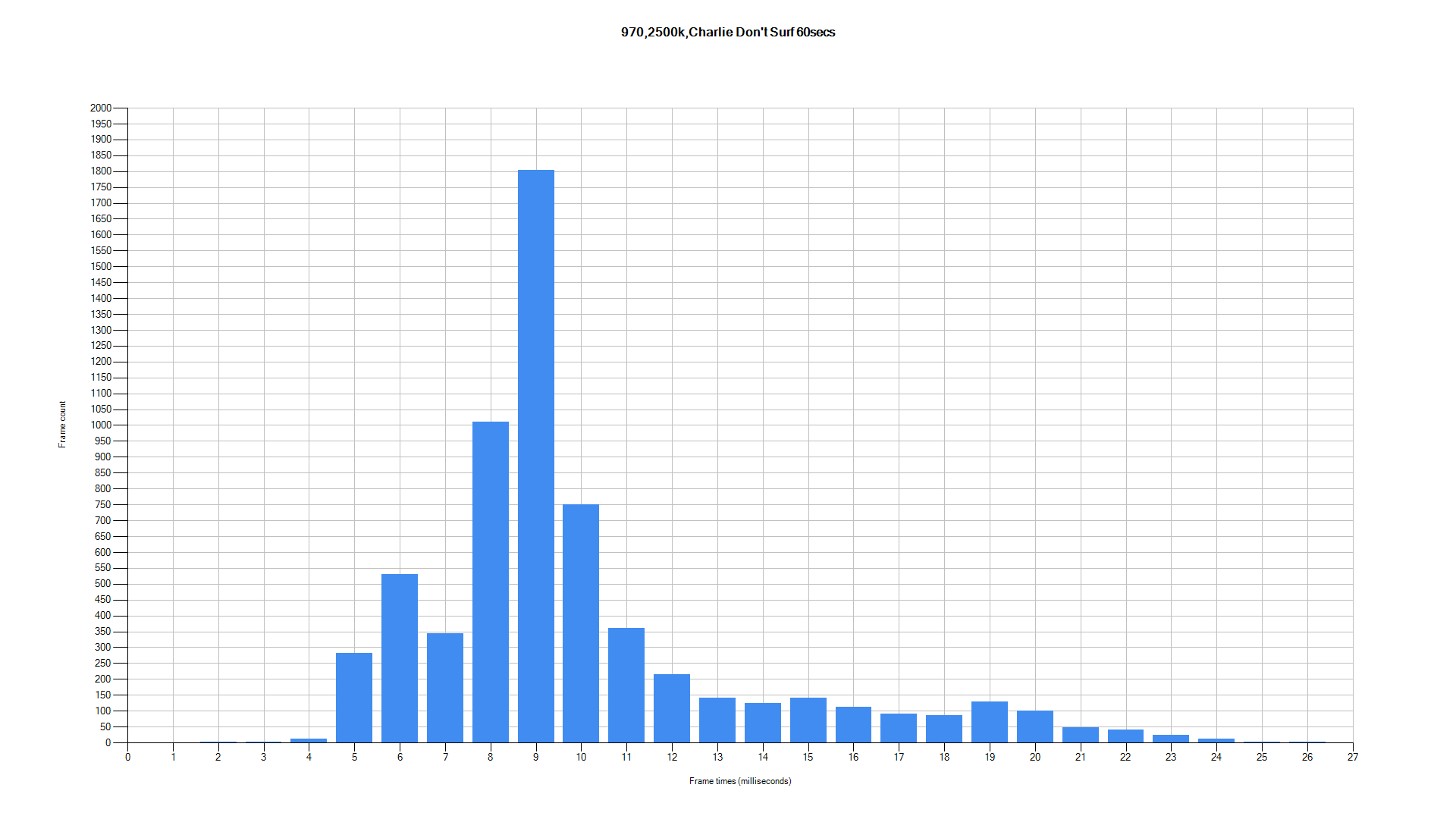

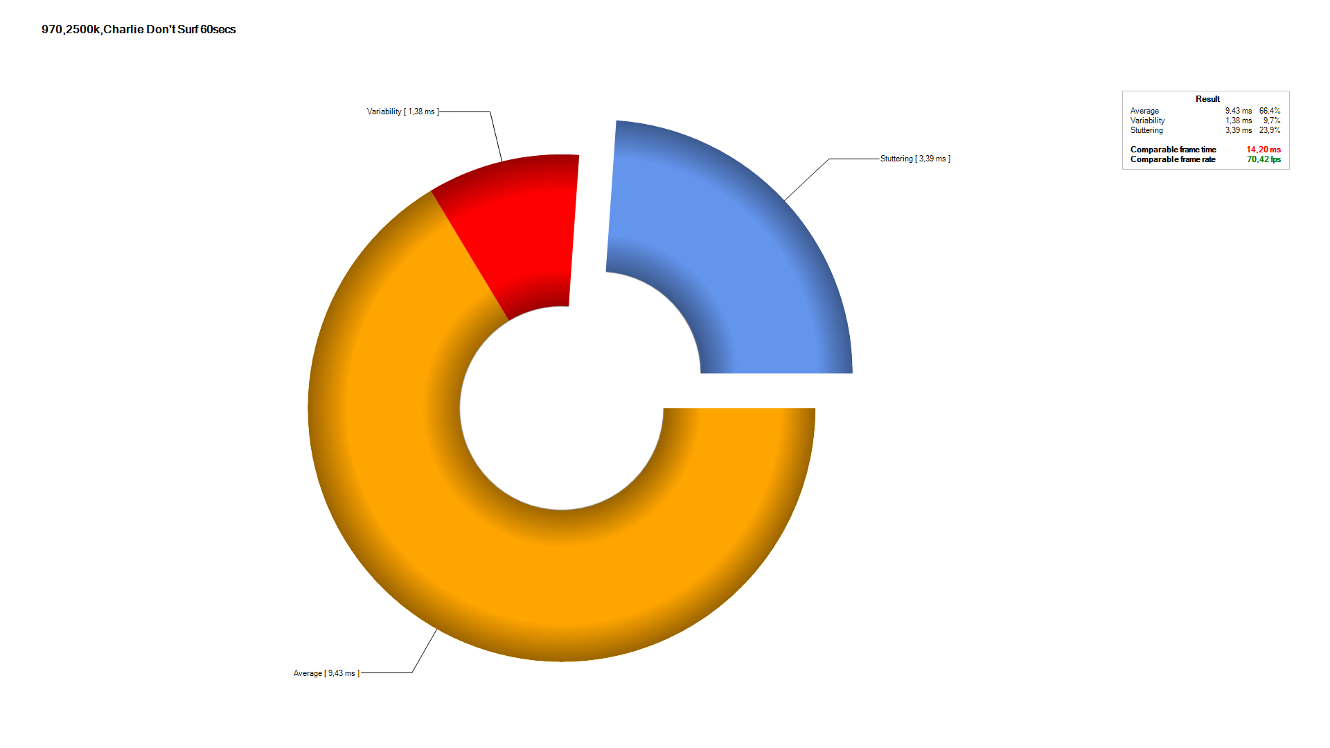

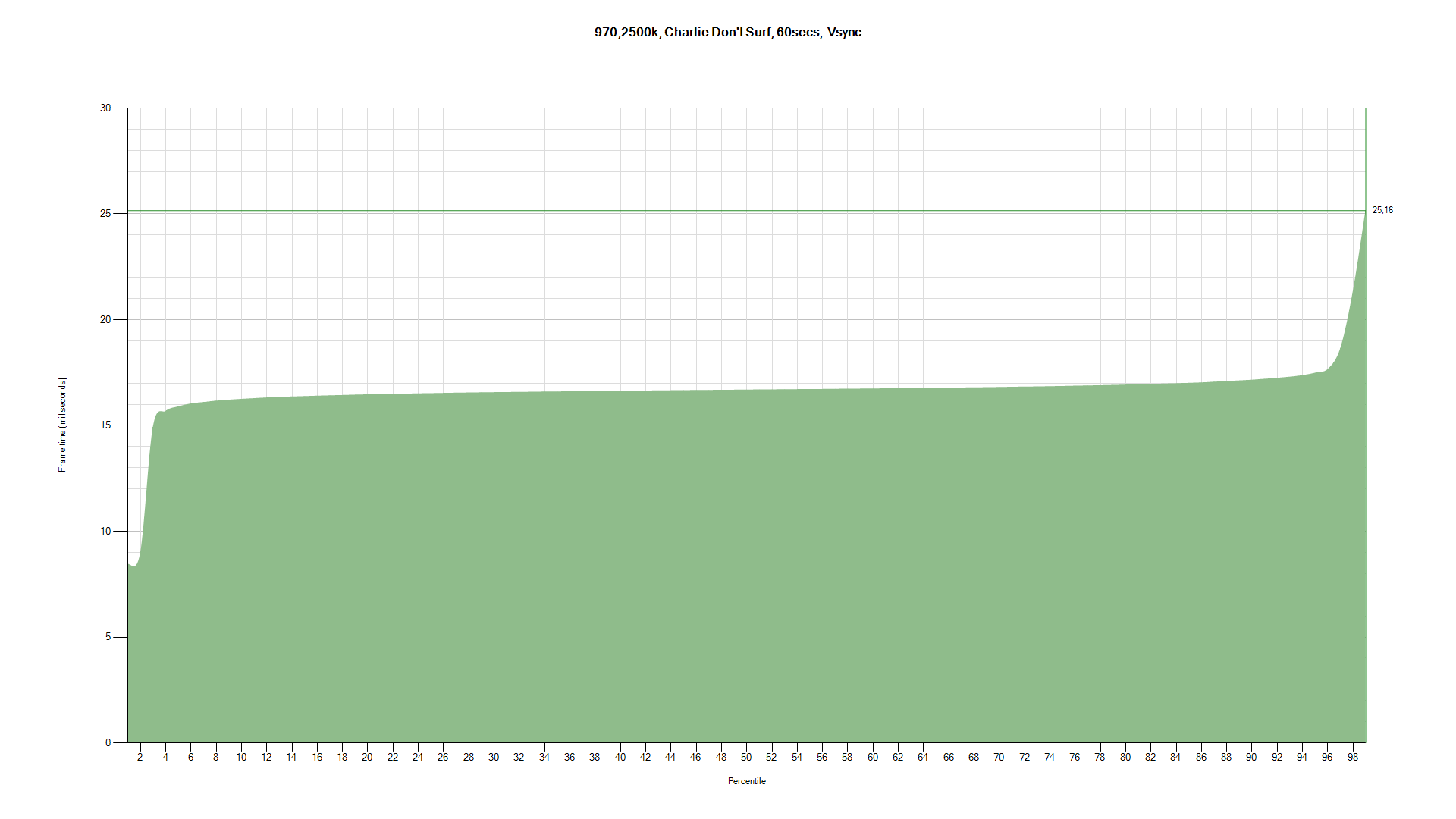

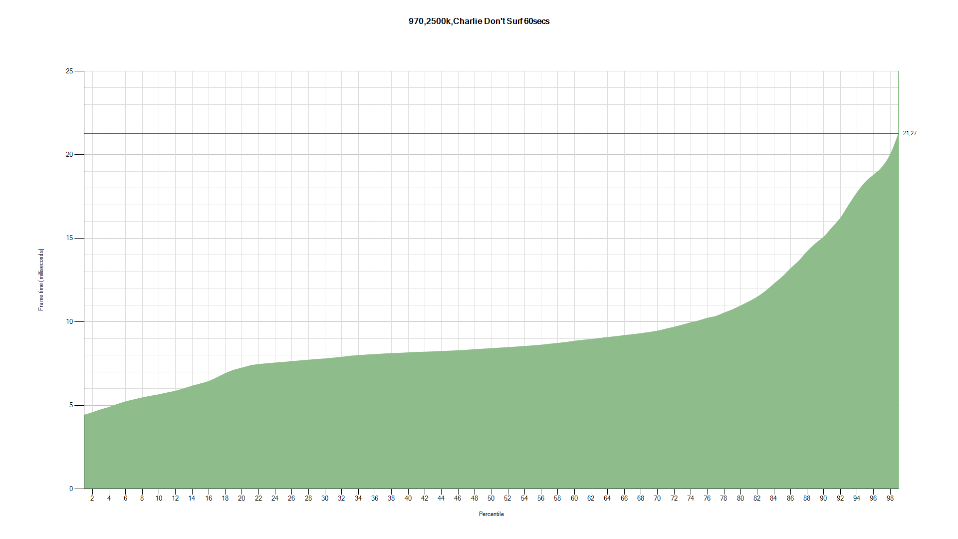

Personally I think graphs like these two are much more informative than the previous frame time graphs. From this it is quite evident that the frame hump starts quite early at about the 86th percentile, where preferably you wouldn't want it to start until the 95th percentile or so. This would indicate that the hump is more prevalent that normal, i.e. affects more frames than usual.
The histogram also clearly shows a secondary peak at around 14-15 ms, and given that this is twice the frame time of the main peak (at 7-8 ms), this would be quite noticeable.
Of course with all this we're still only talking about a game dipping down to 60'ish fps from 130 fps, so it would still be perfectly playable. But if the absolute frame rate numbers were lower, then a relative drop of this magnitude would be very noticeable.

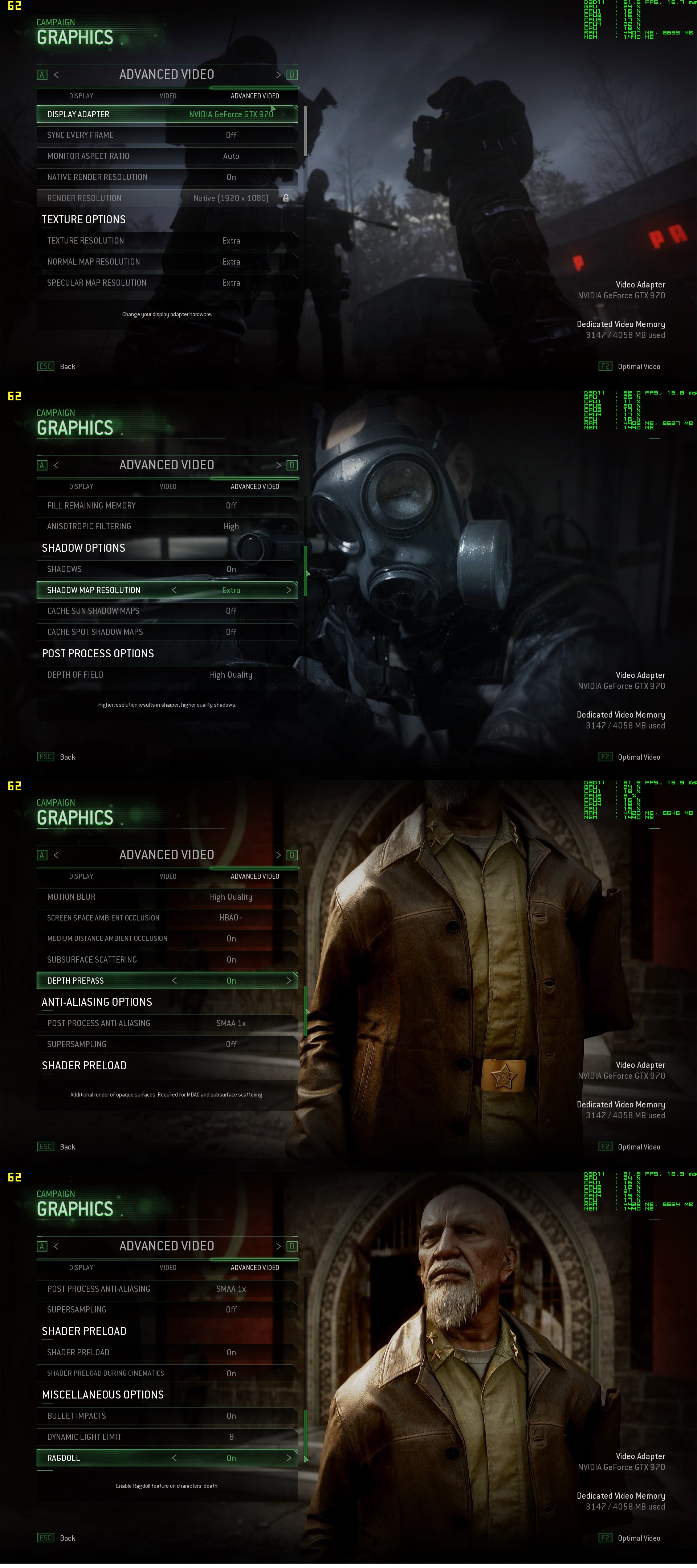

These are the settings I used. Resolution 1920X1080.

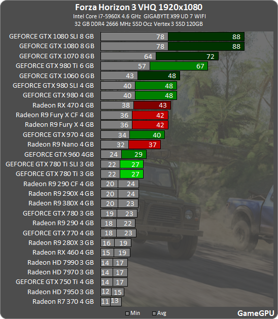

I've seen the 1070 being up to 80% faster in some games. Forza Horizon 3 I think and a couple others.
I think 68% is too much.On pcgameshardware they testing aftermarket cards and gap is usually 50-55%.I think your 2500K holding you back.

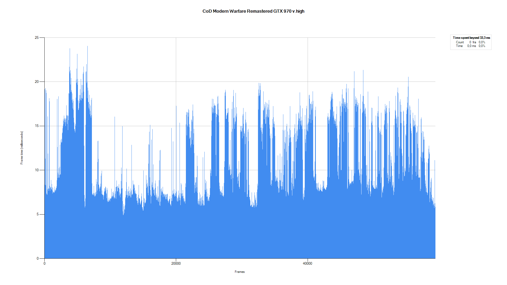

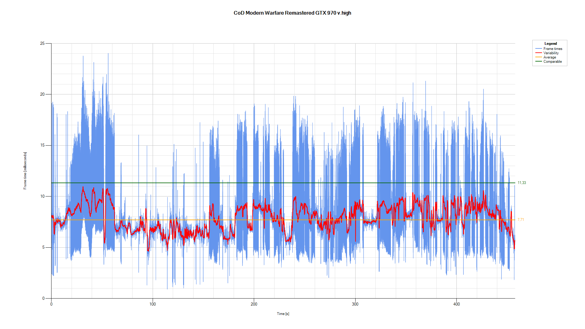

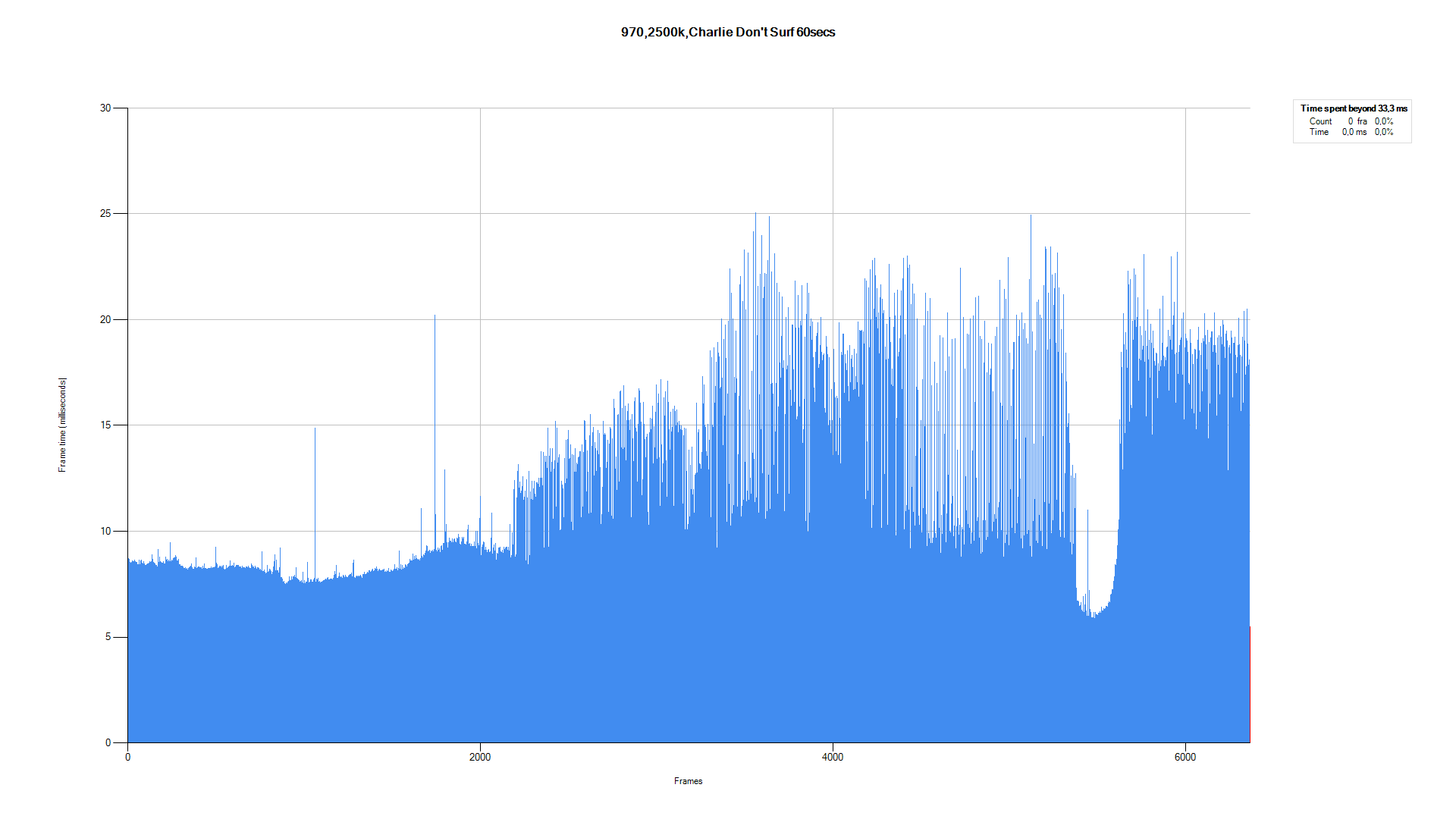

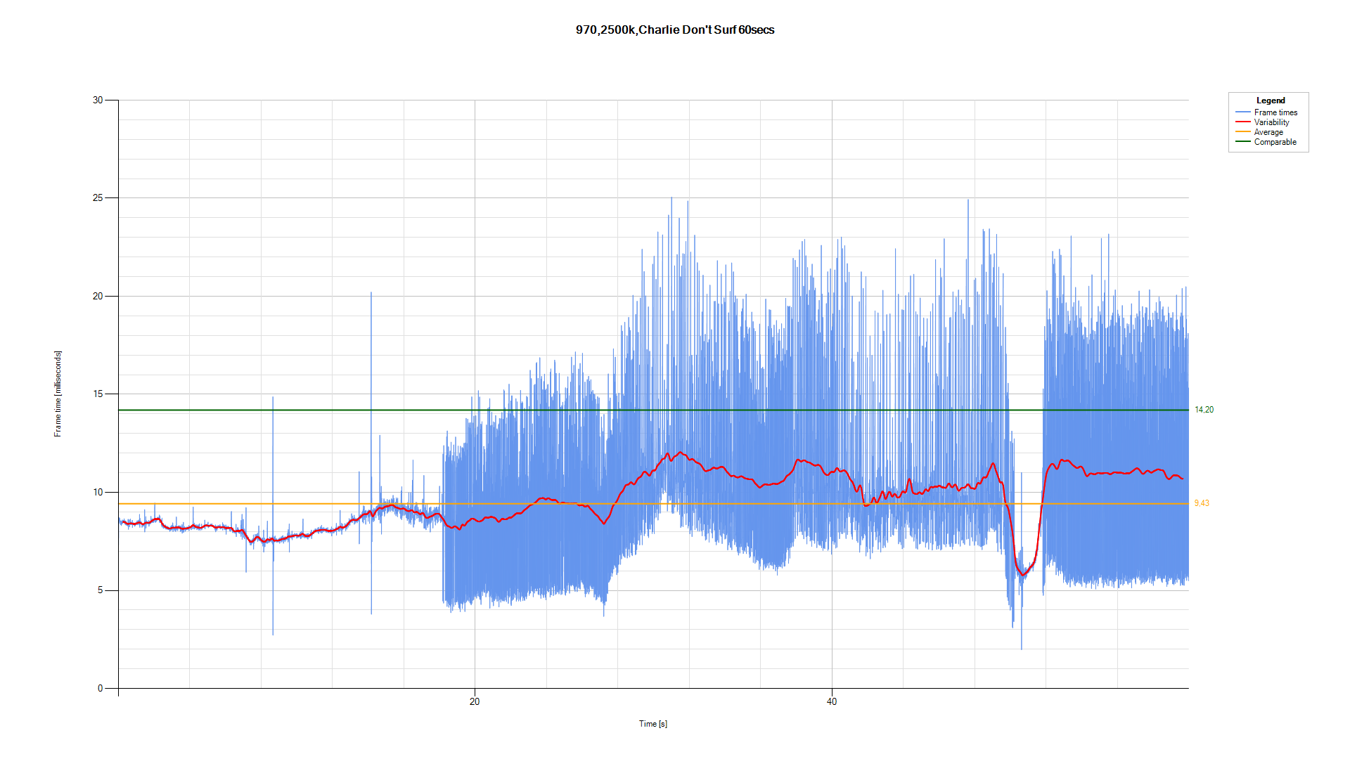

Cool. I did a quick frame variance graph, and we can see largely the same pattern as for the frametime graph.
This graph shows the frame to frame variance, and thus stutter. Generally speaking you'll want to stay below 2-3 ms, up until at least 95-99th percentile. CoD goes above this at roughly the 75th percentile, which is way too early and worse it goes up 7 ms variance at the 99th percentile (for comparison look at this PCPER review, it contains examples of good low stutter games, and examples of high stutter games as well). All in all this is a pretty bad case of stutter, although perhaps not world ending, but of course everyone's threshold is different.
Thank you for your effort my friend. It does seem that the game has some issues with frametimes.
Yes I am familiar with PCperspective's work. I consider trying that method myself, but my grabber records in H264 and fcat needs uncompressed frames afaik. Anyhoo, I will have to make do with fraps data capturing. It may not be perfect, but when there's an issue, it seems that it's capable of illustrating it.
Now don't forget that my runs are pretty long, not limited to 60secs, and when you move about a game engine, chances are that some different loads will pop up from scene to scene. Also my tests force the system to stream a lot of data internally and my benchmarking captures a lot of the system strain. Even an HDD access can produce a spike of 500ms sometimes. I try to avoid that however, because it throws the graph's granularity out of the window.
I am intrigued as to why this specific game seems to have such variance between frametimes, so I did another test. I started the Charlie don't surf mission, and I benchmarked the first 60seconds without touching anything.

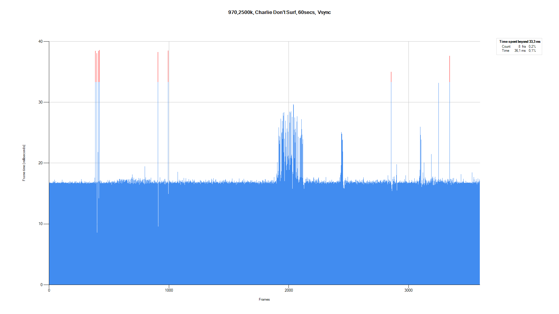

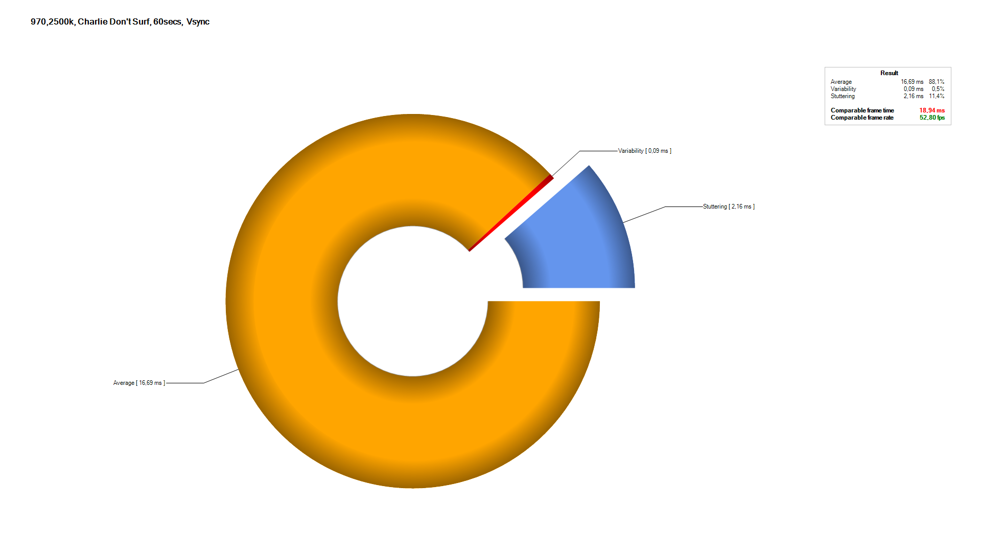

Here are the results I got.

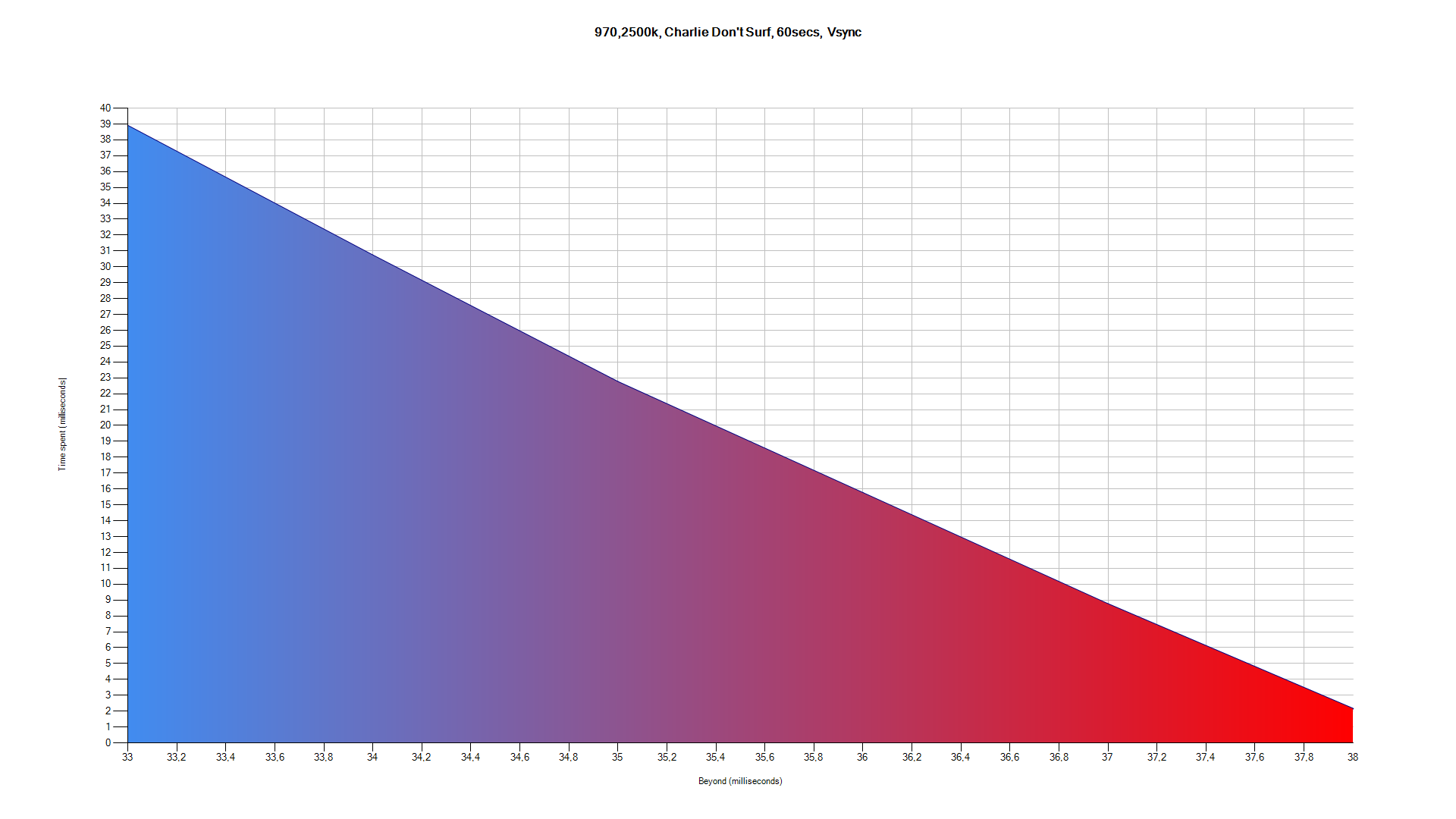

If you look at the frametimes graph, things start going south at about 19secs. That's about the time that the helicopter reaches land and some stuff other than deep blue begin getting rendered.
Out of sheer curiosity I did the same test, but this time with vsync enabled. Now even with vsync, some frames got some big frametimes still.
At this point I understand that I am overtesting things, but I'd like to know why this happens and what hardware combination alleviates this. Truth be told. These things are virtually imperceivable. So I think I am going to ask a friend a favor...! 🙂
