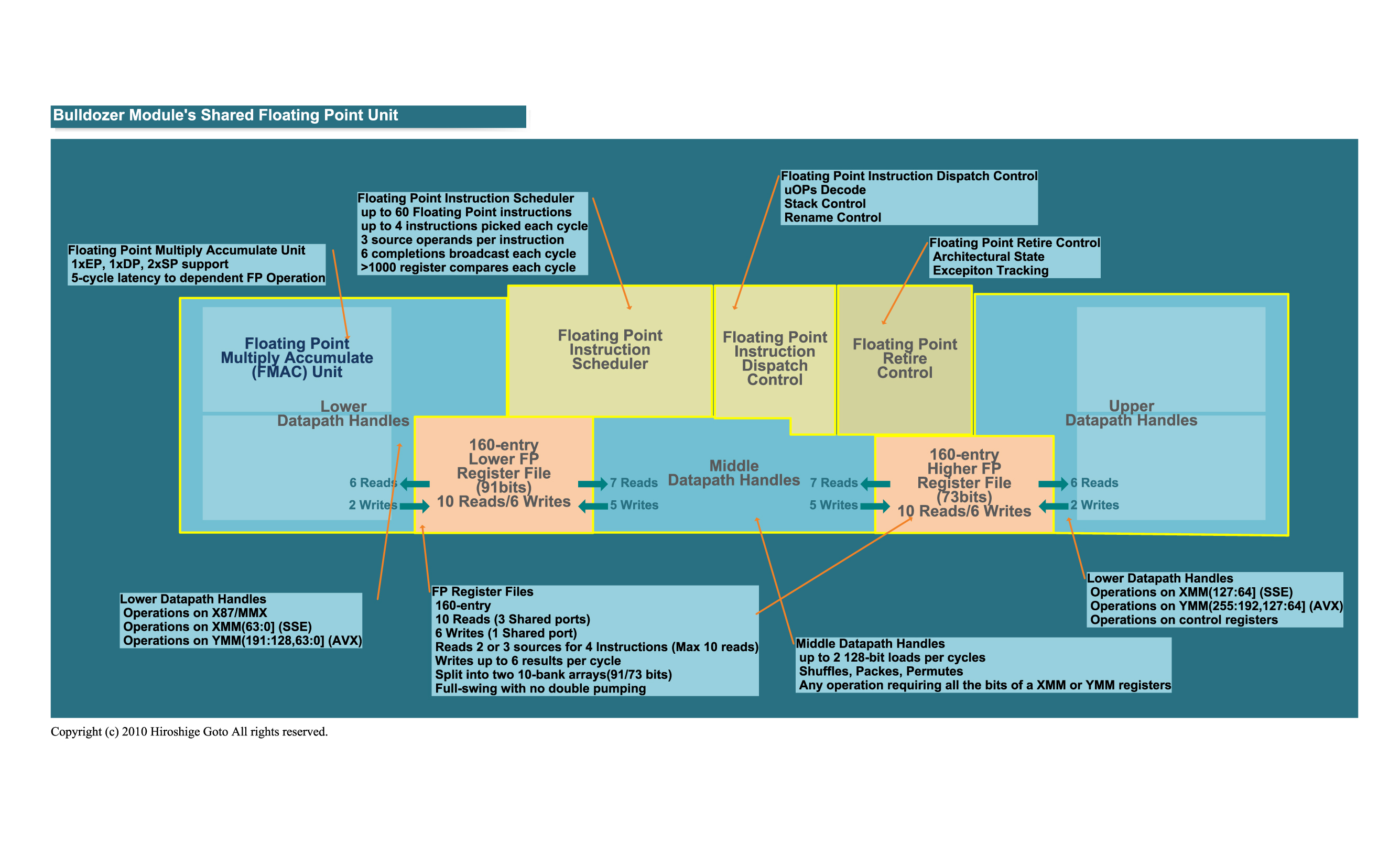

It's really all about the addressable execution units, rather than an "FPU." Bulldozer's FPU is said to be 128x2, but is, in reality, 4x64 FMAC + 4x64 FADD...

Scheduler does only a small part of the work as a X86 instruction imply several uops, in the diagram below we can see that each core has its own L/S unit, as said the operands and operation that are used by the FPU are managed by the thead parent core and maths operations completion is done by the ALU + AGU.
Just a warning: Whoever put my speculative uarch schematic with added colors on Wikipedia, didn't correct my early wrong assumption about the FP units' functionalities. It's been there for years already.

Just a warning: Whoever put my speculative uarch schematic with added colors on Wikipedia, didn't correct my early wrong assumption about the FP units' functionalities. It's been there for years already.![]()
The ALU/AGU have effectively no impact on FPU performance, beyond thread/application control logic, of course. If you have an unrolled loop, or SIMD instruction, the only part the integer block in the module plays for FPU is in the LSU (load/store unit). This is simply because the FPU can't run its own thread and is just an integrated a co-processor - it relies on the thread-control logic build into the integer cluster to reorder (or even discard) solutions from the FPU.
The instructions don't travel through the ALU or AGU at all, but those are responsible for the logic paths that may (and usually do) need the results from the FPU. I am not sure at what point a pipeline instruction chain is discarded in the event of a failed branch detection, but I imagine it is the job of the AGU/ALU to create and compare the results used to determine if the predicted path was valid. In this way, the AGU and ALU performance can effect the FPU's utilization, but not its core performance capabilities.
I thought it was odd that it didn't show any core logic divisions, the "FP Ld Buffer." the MMX units, the BTBs, the uCode ROM, the [D]TLBs, ... the list goes on, of course ;-)
But if you put in too much, it just becomesand
To make it right, the FPU would have to shown with its symmetry in place, with its two internal pipelines. Though, I've taken it as being generally accurate for the number of execution units in the FPU. If this is not the case, it would be nice to know its internal design more accurately.
But it s the thread control logic, hence the ALU + AGU, that limit the FP ST perf of a core...
In Cinebench 11.5 a Steamroller core score about 1 at 3.7GHz and a module does 1.83, obviously it s not the FPU that limit a single core FP throughput, if the core had enough management ressources the score in ST and for a module would be the same.
It may not be accurate physicaly, but it s right about the logical behaviour as usual schematics do not highlight the fact that the FPU is under control of the ALUs, this has lead to extreme confusion as people are generaly unaware that the ALUs are the cores of a core.

FPU overview by Hiroshige Goto
