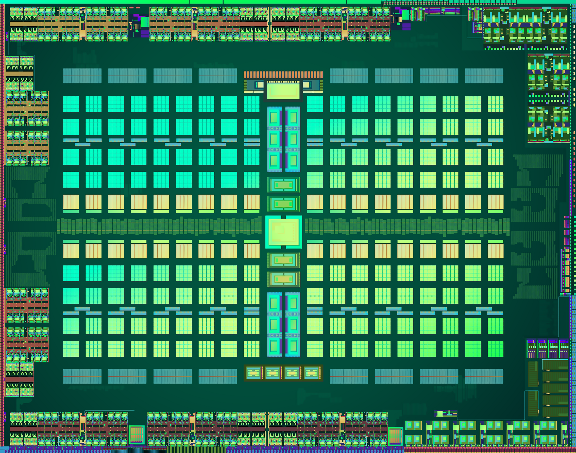

http://www.pcgameshardware.de/screenshots/1020x/2016/06/Polaris-P10-Die-Shot-pcgh.jpg
did PR shop the die shot as well?
Feb 19, 2009
10,457
10
If that die shot is true...
Polaris is a 2880 SP chip with 576 SP disabled to arrive at the 2304 SP part.
I was thinking that they are FP64 units, but then we all know AMD's GCN does not have separate FP64 Stream Processors. The SPs are linked via a hardware scheduler to operate FP64 instructions at a lower ratio, 1:2 in Hawaii etc.
Thank you for proving me correct, P10 in it's 2304SP configuration is a cut-down chip. Apple took all the full chips, again.

AMD has said that RX 480 is the full Polaris 10, so I don't know why you keep saying that RX 480 is cut down.
Listen buddy, I don't give a rats what AMD or NV PR says about hardware specs, they have lied in the past. Your memory is very selective.
IF the die shot is true, Polaris 10 is 2880 SP.
You can argue the die shot is fake, whatever.
11,715
2,012
The additional 576 SPs you refer to are very clearly in a different color than the 2304 others. Maybe they're disabled but they could also be something different like double precision units or something.

Those yellow colored units look to be the TMUs. Each block corresponds to 4 TMUs for a total of 144 TMUs, which lines up with what we have for the RX480.
Each block of 64 SPs + 4 TMUs is one CU. 9 x 4 groups of CUs gives you 2304 SPs.
The two 'L' shaped blocks on the top-left and bottom-left are the memory controllers. Looks like 8 groups, so 32-bits per group gives you 256 bit memory bus.
Of course, this is assuming the diagram is even accurate.

@Saylick
Thank you, if that is 4 unit blocks, then they are TMUs. In the picture I had from PCGH, it looks like 16 unit blocks.

@Saylick
I don't know why they used JPEG compression. That introduced artifacts that made the TMUs look like the blocks.
In any event, the PNG image makes it clear those are TMUs. So we are back to Polaris 10 full fat being 2304 SPs.
