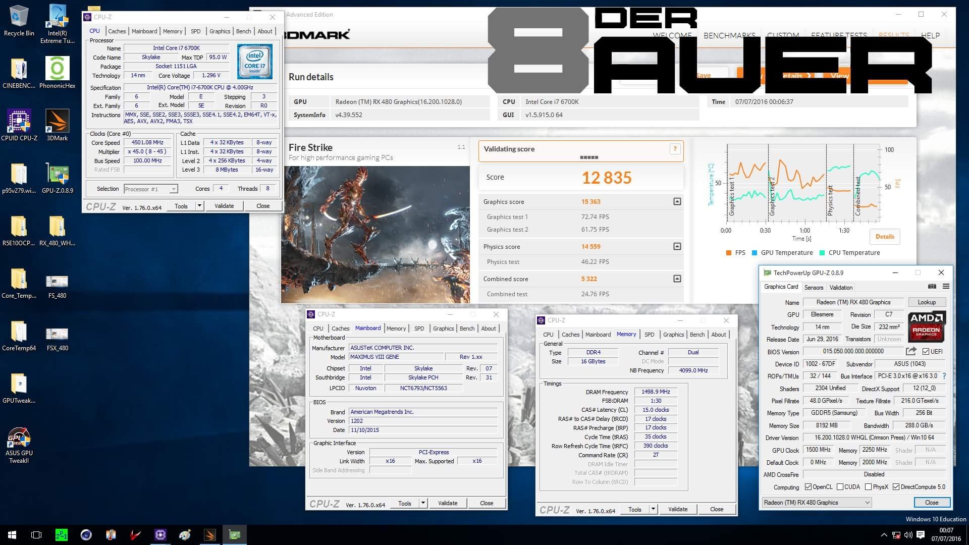

Some dude just overclocked a reference RX 480 to 1.5GHz..
He obtained near Fury-X performance. Add another 200MHz or so and you should be near GTX 980 Ti performance... with only 32 ROPs.
