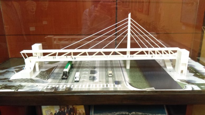

It was supposed to be a suspension bridge.
View-1-comp%20(1)
This is what it was supposed to look like when done.
*Cable Stayed, not suspension. https://www.quora.com/What-is-the-difference-between-the-cable-stayed-bridge-and-a-suspension-bridge

The bridge is NOT a cable-stay bridge in mechanics. It only looks that way for aesthetic reasons. If you look at the detailing of the connection from the cables to the deck, it's held together by a few anchor bolts and is not as robust of a connection than if this were a true cable-stayed bridge. Also, a true cable-stayed bridge would not be self supporting until the cables were taut and properly secured to the deck.
