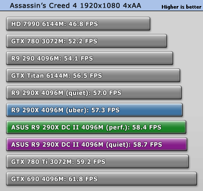

If DCL is fundamentally broken, why did it work in Civ 5? The last benchmark of Civ 5 on Anandtech was in the GTX 770 review, and you can see the GTX 780, the most CPU limited GPU, is nearly 50% ahead of the 7970 Ghz, despite being on average 20% faster:
Also, AC III was confirmed to use DCL, and likely AC IV does as well. NVidia has a large lead in that game, with a GTX 770 roughly equal to a 290x:
And then the biggest knock against Repi's statement, is that Project C.A.R.S has been confirmed to use DX11 multithreading. In fact, the entire renderer has been built around it. I think this game will finally give the technology some good press, because it's a really big next gen title.
So whilst Repi might claim the technology is broken, other developers have been, or are making use of it.
This test was made day one of AC:IV

I'm sure Repi has forgotten more about programming than most (or any) of us here, but anyone that has a free thinking brain will find issues with that statement.
