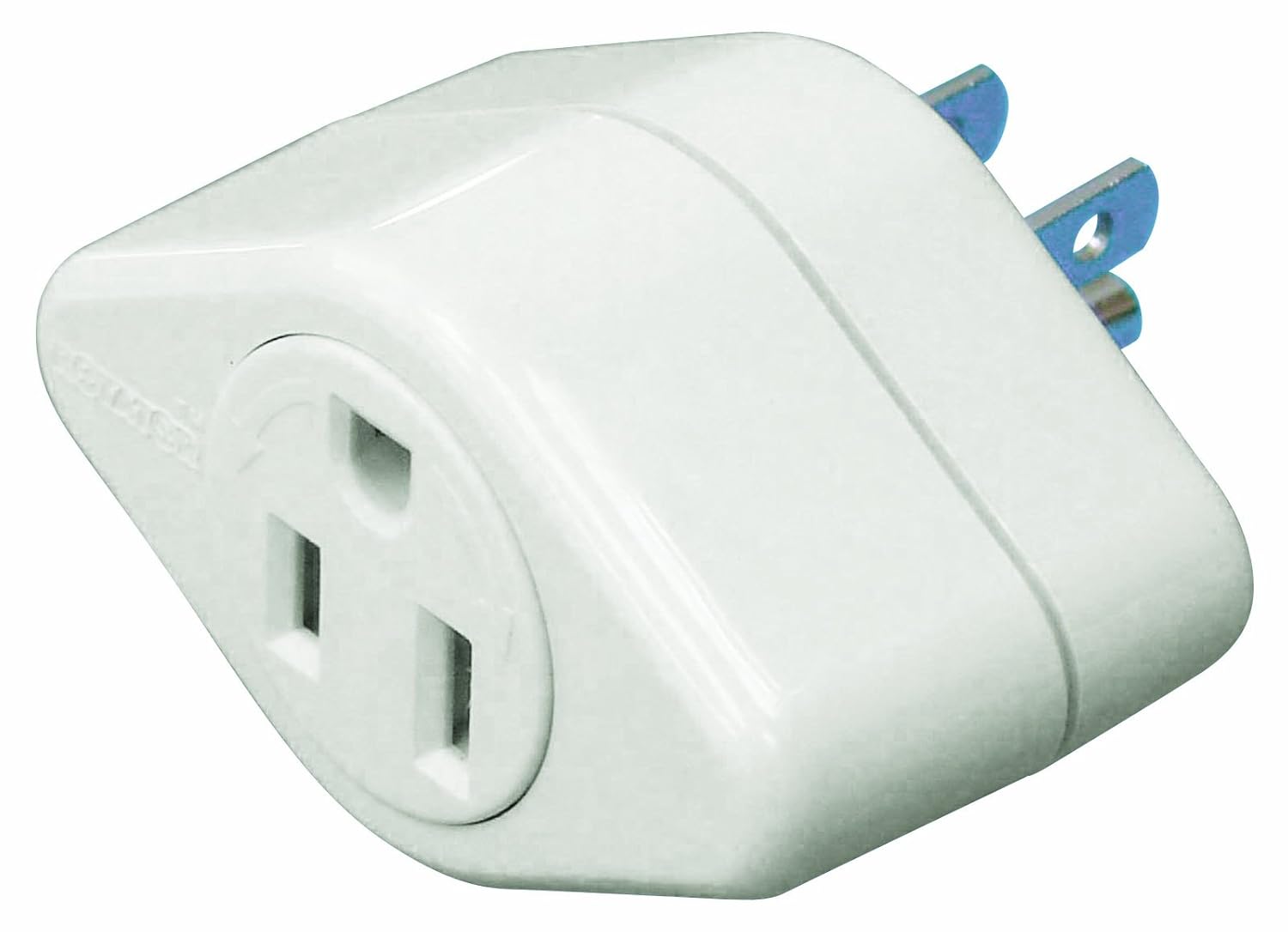

Ken g6
Moderator
Dec 11, 1999
16,603
4,521
75
This took awhile to find on Amazon.
Apparently the outlet can rotate 360 degrees, so you can have it at whatever angle.
Nov 26, 2005
15,189
401
To sum it up. I didn't find one with an inverted plug, but I want that one that's posted. Thanks for the link. What I did find out is the LED night lights do not have the wide neutral prong with the normal sized prong and would work to suit my needs. What I also found was that LED night lights that say they are "soft light" are not the soft light found with bulbed night lights. That how-ever does not suit me well.
