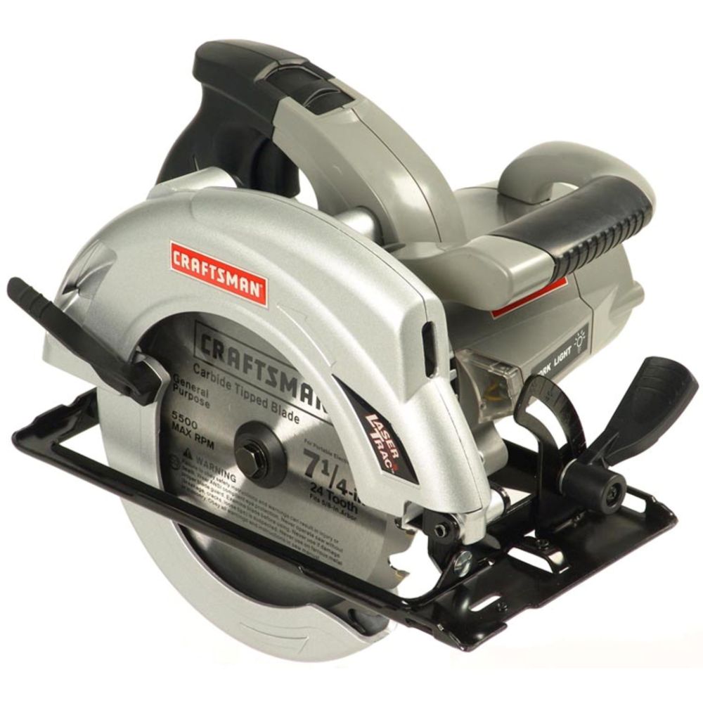

slate bar/reciprocal saw...
circular saw is well, super dangerous:p
why would a circular saw be dangerous?!
