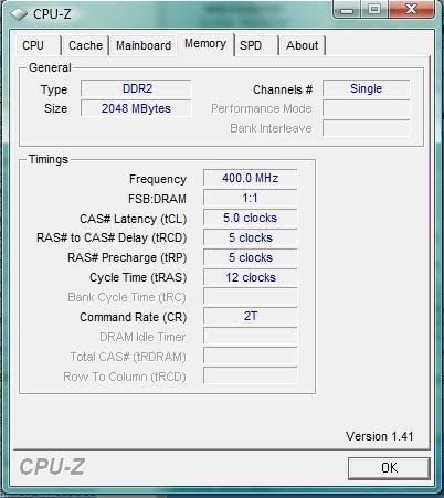

K i pulled out my 2nd 2gb ram stick and tried to get it to post with 4-4-4-12 1:1 400mhz with the memory voltage at 2.2v. It wouldn't post, I even tried upping the FSB voltage and the (G)MCH each to +.3v but no dice on getting it to post. Anyone have any tips on why this wont work??
It would be helpful if you put your Rig in your signature. I have to keep going back to your earlier post to see what you have :)
Do you have 4 x 1 gig memory or 2 x 2gig? If it is the later, that might be the problem. I heard patriot ram is good but it might not be good enough.
Somebody correct me please, but don't you need at least 2 sticks of ram for DDR2 to work?

I've got two sticks of 2gb ram gonna fix sig now. but I cant seem to get it to what patriots website says it should run in either setup.

Run CPU-Z. Click on the memory tab. Do this with just one 2gig stick in. What does the "type" & "channels" say?
Also, what do the timings say?

Just what I thought. You are not running in dual channel mode with just one 2gig. But I realize that it doesn't work with both sticks in either. Both ways could be part of the problem. I am not a memory expert hopefully somebody will chime in.
Have ever gotten the 4-4-4-12 timings to work even at stock volts and speed? what was the highest speed you OC'd when you lost those timings?

yah when i had 4gb in i had them running at (9x343) 4-4-4-12 1:1 which of course is very minimal overclocking.

K did that and got the 2 sticks of memory running at 344MHz 1:1 4-4-4-12 but cpu speed is only 3096MHz (9x344). Moving the gMHC up didnt do much if anything. fsb voltage and pci voltage are normal.
Would it make sense to make it not 1:1

At this point I'm not sure what to tell you. The E6850 is 3.0 ghz stock and you are barely OC'ing it.
It should have no problems doing 1:1. What is your vcore at 9x343? How high did you try to raise it?
Here is a couple or more things you can try:
1) try the 8x multiplier and see if that helps. Maybe start at 8 x 375 and work your way up.
2) Maybe one of the 2gig sticks is bad. Pull the other one out the try that.
I don't know how good Patriot memory overclocks. Can you return it and get Ballistixs?

@wsscreamer
oh man! I thought you said you had 4-4-4-12. I should have check myself :) No wonder it's not working for you. :) Problem solved!
