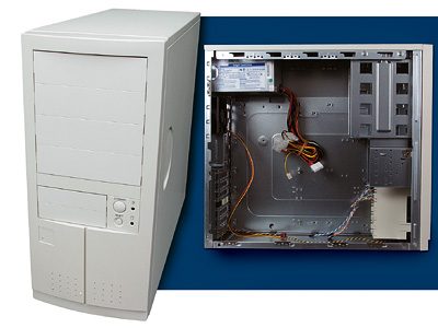

Do you remember this case?
I think the point of newer cases is that it's a lot more of just a frame and little to no structural support outside the fram. For example on Fractal one of the strongest built enthusiast cases the whole center area at the top are plastic plates to hide sound deadening material, where these old Antec's/Chieftec's the top was like 6mm thick steel riveted to the frame. The doors on these cases where nearly as heavy as most cases empty are today.
I agree with you. I don't think it is practical to make the huge, heavy, mostly higher grade metal cases anymore. Too expensive to both manufacture and ship. Cases today are becoming like everything else. Throw away's made in China. Looks good at a distance but under close inspection not very well made.

I had a gray Antec branded one of these and a blue and red Chieftech version, and while I have fond nostalgic memories of these cases I cannot imagine buying one for $80+ in 2018.
Corsair forever raised the bar for cases with the 800D, and subsequent cases have only refined the formula. For just one example, look at the the Phanteks Enthoo Pro. $89 gets you way more features than anything the Dragon could offer....

CHEIFTEC was the OEM manufacturer of this case and re-branded it for all of the other companies with option for different bezels, including Alienware
I was pleased to see they're making a new case, the scorpion, but only avail in EU, http://www.chieftec.eu/de/
Not quite.. A little more research. Apparently Chenming is the actual manufacturer of the case. Probably the actual builder of Antec's cases back in the day, so they were the OEM supplier. Doesn't tell us who is actually responsible for the design (because Antec, Corsair, and most other american computer brands don't actually manufacturer anything). But either there deal was not exclusive or was them ordering a Chenming design for their brand.
From their EU site they have that x-pack cube case, which Apevia sells here in US. So maybe they'll bring it over?
