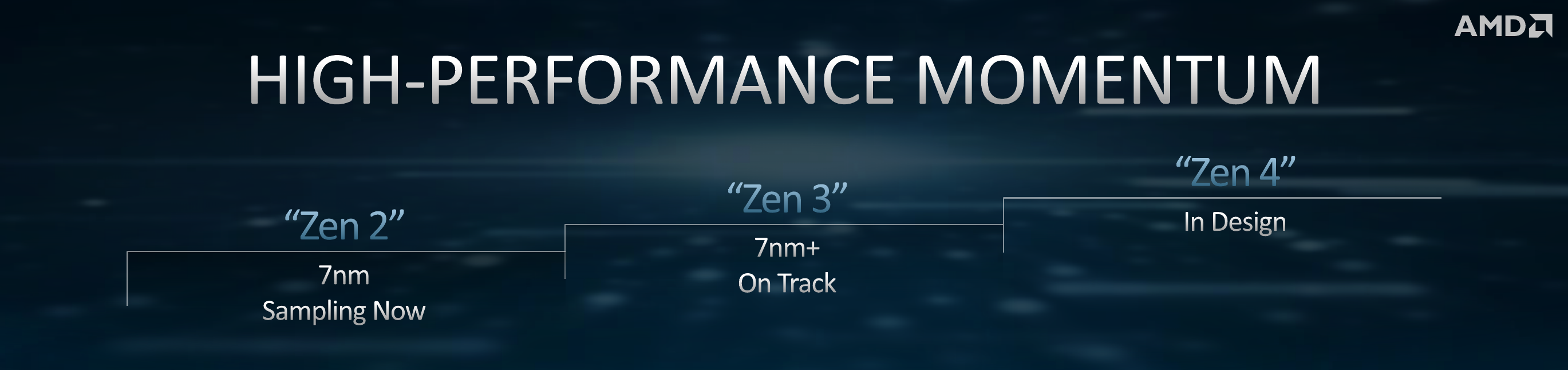

I hadn't remembered the old road map; just found it.
Zen3 is 7nm+ and on track. Zen4 design is surprisingly near design completion. Maybe Zen4 will be SMT4?
