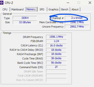

What does CPU-Z say in this section, because that's where it would generally show you whether you have something in dual-channel or single channel? Older versions sometimes explicitly say "dual channel"; sometimes it'll just say 2 x 64-bit.

I've done a few searches and it is very unclear. The "first" slot closest to the CPU is labled 3. I've looked at few videos and the modules are usually installed in every other slots. What version of CPUZ is that because mine does not look like that. Mine says single in the channel box. I'll have to look again. Speccy reports single channel as well.
