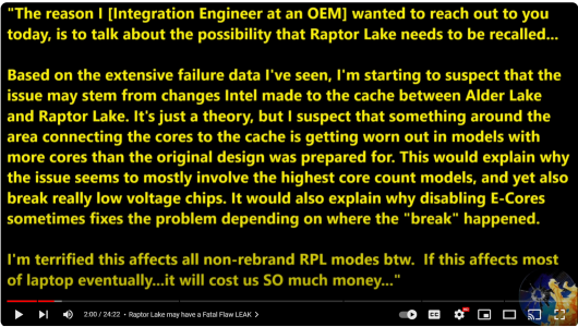

Somebody sent MLID a speculation, that there is something wrong with Raptor lake design, he then added information that Raptor lake has been developed very quickly, suggesting that mistakes could have happened.
I do not think that this may be the real problem, because every piece of technology has its limits and conditions, in which it can work well long term and other, in which it is stressed beyond its limits and it will fail.
Intel upgaded their 10 nm process for Raptor lake CPUs and bragged about how this new improved process can handle up to 1 GHz higher frequency. Perhaps they were too optimistic. Perhaps the real improvement was much lower. Perhaps the improvements actually impacted long term reliability and is in this respect even worse than the previous iteration of the process.
If there was something critically wrong with Raptor lake CPUs, they would fail in Intels testing prior to launch. These CPUs may have some hotspot/s in them, which will get stressed hard in certain conditions (combination of frequency and voltage resulting in high current density and temperature), but when these conditions are not met, they can happily reliably work long term.

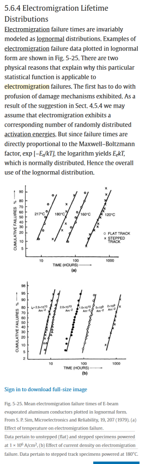

I just learned, that according to Blacks equation for electromigration doubling current density can mean reducing mean time to failure up to a fourth, with higher temperature making it even worse.
EDIT:
I tried to calculate Blacks equation for the activation energy 0,9 eV, current density exponent 1,2, doubling current density and increasing temperature from 60°C (333K) to 100°C (373K), and I got 66 times shorter time before failure. Did I make a mistake in the calculation? It seems wrong.
I just found something supporting my (probably not very accurate) result, that electromigration is strongly dependent on temperature.
Increasing temperature by 57/60°C caused tenfold decrease of the time to reach the same amount of failures.
