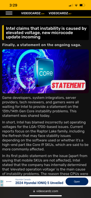

Here's how I see it. The bar isn't nearly that high to clear.
Thread title plus bold sentences are a hypothesis + Mark understood and agreed with the hypothesis in a post that many have almost exactly repeated the last few months = bar cleared.
Here is the statement, just like I said it’s the voltage was too high.
