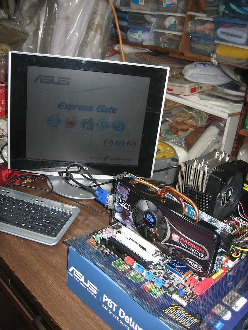

This is a crappy picture but this is how I initially tested my parts before I spend the time to install them into the case. Just nothing but the motherboard, power supply, video card, RAM, CPU, and CPU fan.
Oh be sure to rip open those 2 thin metal plates above your USB ports off so you can plug your network cable in O_O
