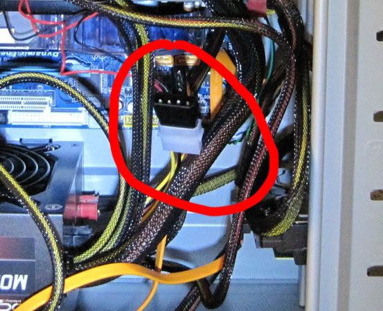

K I figured out something, unlikely to be related to why your computer has boot problem, but I'm going to address it anyway. You are using this to power your 2 case fans. One end to the PSU, and the molex ends to the case fans. IT IS WRONG! That power adapter is used to power video cards. Use the molex cable that came with your power supply to power the case fan.
Maybe that's why his video isn't working. The end that the case fan is plugged into may need to go to another molex connector.

i didnt see the pci-e power adapter.
in fact, i still don't see it.
Dont worry, I didn't see it for a day. I couldnt figure it out what's wrong w/ it but a light bulb lid up while I was driving home.
Here I think I'm putting too much effort into investigating this: PCI-Express power adapter explained. But then again I can't be sure if this is what's really causing the boot problem, but it's worth looking into and try to connect it the right way.
