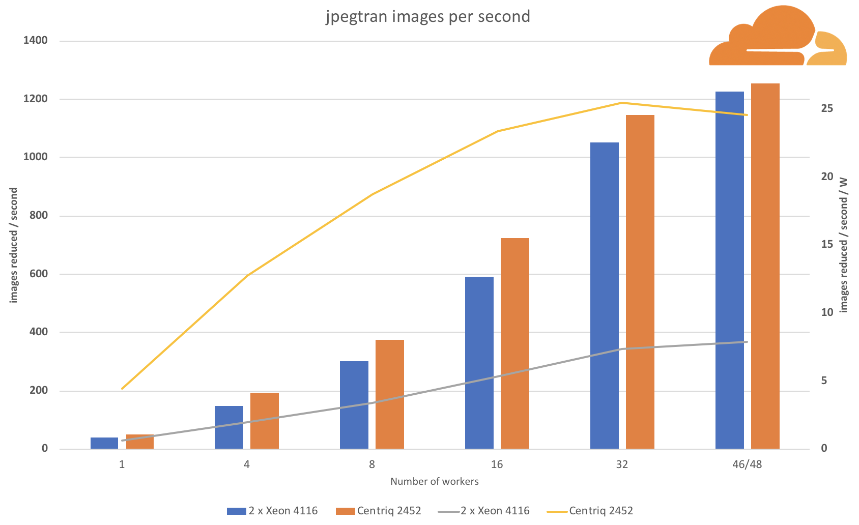

Cloudflare posted another blog entry: NEON is the new black: fast JPEG optimization on ARM server.
Nice to see Centriq more than 6 times more power efficient than a Bi-Xeon, while being faster at the same time.

* falkor presentation is full of spec rate, cloudflair workload is obvious.
It was probably obvious, but until now there were not many widely publicized and detailled analysis were an Arm server was that competitive, even on workloads that were supposed to be Arm friendly.
