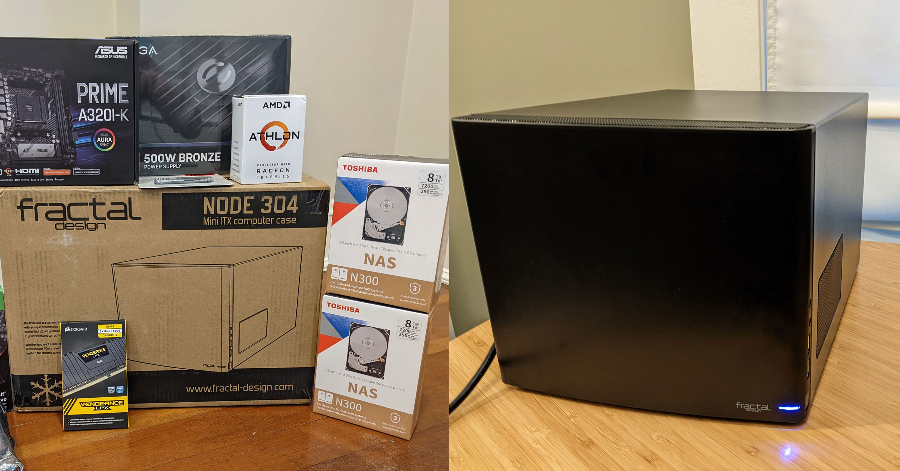

Here's a good starting point for cases.
I used a Node 804 which has 8 bays for 3.5" drives and is a cube that holds an mATX board. I ran a 870K CPU with air cooling just fine since there's space for 8 fans inside and the storage is segregated from the rest of the parts to keep the airflow isolated and cool.
Currently I'm using a Meshify 2 case and that's due to the ADL boards at the time not offering a mATX option and even now those options are limited and not all that spectacular in specs. The M2 holds up to 13 drives in storage mode. Plenty of airflow with 7-8 fans being able to be placed inside.
When doing the M2 one of my focus points was adding a USBC to the front / top for easy access to sync drives or boot from USB when needed. Using the header on the MOBO works just fine but, if you want to boost the speeds you can get a card for a slot and bump it up. If syncing things with an external drive for a backup you could add a TB4 card to the mix for 40gbps which would make backups faster if using an NVME but, for a spinner they usually top out at 200-250MB/s anyway which isn't even close to needing TB. The one perk of TB though is you can get the system to boot windows from an external drive. Then again I also have a SanDisk Pro that can do the same since it shows up as an SSD to the OS and hits ~300MB/s.
It all depends on how you'll use it and leaving yourself with options for the future. If I needed to I could use the system as a normal PC option in the event of my laptop failing for some reason. While it doesn't have a GPU inside the case the system would suffice for finding a replacement laptop or just add a GPU for some higher end needs besides browsing.
