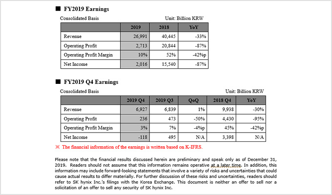

Seems this might be a valid leak from inside partner SK Hynix..
Twitter
Big Navi - Radeon 5950XT: Twice the compute units as Navi 10.
Shading units: 5120
TMUs: 320
Compute units: 80
ROPs: 96
L2 cache: 12MB
Memory: 24GB (4 x HBM2e, 3 die)
Memory bus: 4096 bits
Band Width: 2048 GB/s
ergzz28uuaaa2wf-jpg.17447
All these Big Navi numbers are perfectly consistent. The 96 ROPs are tiny pieces of logic at the edge of the memory tiles of the 12MB L2 cache which explanes the factor 3 in these numbers. An old example here https://bjorn3d.com/2010/01/nvidia-gf100-fermi-gpu/
SK Hynix will make 6GB HBM2e stacks with 3 dies per stack for consumer applications on request. SK Hynix recently announced HBM2e at 512GB/s at ISSCC-2020. Samsung went a step further with 640GB/s HBM2e (5 Gb/s/pin)

Fake. Though we've discussed it over Twitter already :p
I mean, if nothing else, I don't think any consumer-facing Navi dies will be using HBM2 of any kind. Especially not 4 stacks of 6GB HBM2, which doesn't actually exists - meaning AMD would have to request for it specifically.
AMD. The same company that it ordering as little N7 wafers as possible to prevent oversupply.
Well, you are entitled to your own gut-feeling.
AMD always used HBM for it's top-level consumer graphics cards during the last 5 years: Fuji and Vega64/56.
I can't see anything wrong, neither can I guarantee anything, so there's no way telling if this is fake or not.
Glo.
Apr 25, 2015
5,930
4,991
AMD used HBM2 for top-end cards because they were professional/HPC chips that were repurposed for consumer market.
Vega II, RDNA and RDNA2 based GPUs have different purposes. There will not be large chip for consumer market with HBM2, unless suddenly coronavirus has made HBM2 packaging viable from manufacturing point of view for consumer market.
The only thing that is correct in that slide is CU count, at least when it goes for large RDNA2 based next gen GPU.
Anything else is pretty much wrong.

Does SK Hynix have 3-Hi HBM2E stacks in portfolio?
24GBs over 4096-bit should be 4x 3-Hi (6GB) 1024-bit stacks
They announced that they can go up to 12-Hi (24GB) stacks before
Not to be left behind, SK Hynix is now also readying their own HBM2E memory. In terms of performance, SK Hynix says that their memory will be able to clock at up to 3.6 Gbps/pin, which would give a full 1024-pin stack a total of 460GB/sec of memory bandwidth, and in the process the lead for HBM2E memory speeds. And for more advanced devices which employ multiple stacks (e.g. server GPUs), this means a 4-stack processor could be paired up with as much as 1.84TB/sec of memory bandwidth, a massive amount by any measure. Meanwhile their capacity is doubling, from 8 Gb/layer to 16 Gb/layer, allowing a full 8-Hi stack to reach a total of 16GB. It’s worth noting that the revised HBM2 standard actually allows for 12-Hi stacks, for a total of 24GB/stack, however we’ve yet to see anyone announce memory quite that dense.
AnandTech - SK Hynix Announces 3.6 Gbps HBM2E Memory For 2020: 1.8 TB/sec For Next-Gen Accelerators

It''s fake. AMD isn't going to roll out a new high end offering for the 5000 series. This year is RDNA 2, which would be RX 6000 series. AMD also doesn't use xx50 for current gen Radeon stuff. They use xx00 and xx00 XT. A web page is pretty easily manipulated. I can take a picture of AMD's website listing the exact same specs.

All of the specs are legit, except the 24GB hbm2e. Its just giant overkill on a consumer level GPU. Maybe this is a professional GPU, MI200?
Pretty sure this is Radeon Instinct MI100, the specs pretty much match up, other then the memory amount..
VideoCardz said:
Today TechPowerUP confirmed that they have the first BIOS in their database for a yet unreleased Radeon MI100 from the Instinct series... The MI100 is believed to be a 32GB graphics card featuring HBM2 memory, TPU confirms it supports both Samsung (KHA884901X) and Hynix memory (H5VR64ESA8H)... Lastly, the Instinct MI100 is likely not based on the exact same Big Navi we expect in Radeon RX series
Techpowerup said:
Arcturus' debut as a Radeon Instinct product follows the pattern of AMD debuting new big GPUs as low-volume/high-margin AI-ML accelerators first, followed by Radeon Pro and finally Radeon client graphics products. Arcturus is not "big Navi," rather it seems to be much closer to Vega than to Navi, which makes perfect sense given its target market. AMD's Linux sources mention "It's because Arcturus has not 3D engine", which could hint at what AMD did with this chip: take Vega and remove all 3D raster graphics ability, which shaves a few billion transistors off the silicon, freeing up space for more CUs. For gamers, AMD is planning a new line of Navi 20-series chips leveraging 7 nm EUV for launch throughout 2020.
Also think Arcturus is based on the "VEGA2" architecture and not meant for gaming.

I think this maybe be true just because of the 96 ROPs. One would expect 128 ROPs for 80CU based on the 40CU 64ROPs of the 5700XT but AMD in this past years is being cheap on the ROP increase.
290X had 64ROPs in 2013 and is still the max that they did.
What business is it of Hynix to know the non-memory related specs of the GPU? I can understand board partners being privy to that sort of info, but not Hynix.
