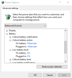

For the shut down at 30% check your advanced power settings.
