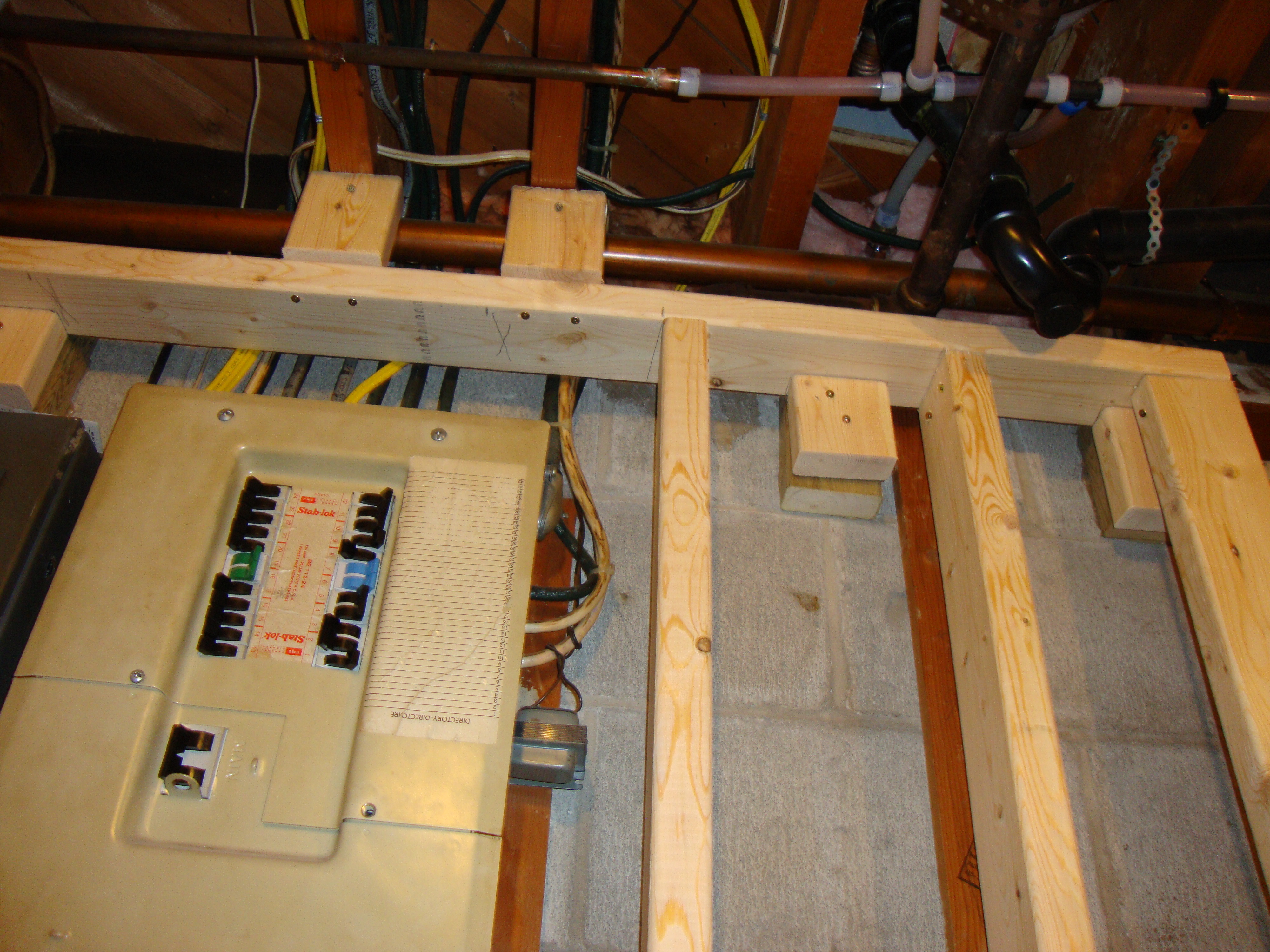

70,792
13,877
I still need to do the 100a feed to my server room and garage. My server room has a dedicated panel but it's fed by a single 15 amp circuit lol. That was suppose to be temporary. My current main panel is too physically small to fit 2 big 100a feeders into so I need to swap it out, and also surface mount it on the wall instead of flush mount as it will make it easier to run the big feeders. I kinda need to do my UPS upgrade before I do any of that though as it would require at least several hours of no power to the servers while I'm swapping the panel.
I could cheat and just do 40 amps though since that would fit in the current setup, since realistically I doubt I'll ever use close to that considering I'm not even overloading a single 15 amp leg. The server room panel feeds the whole basement and not just the server room though.

You need to upgrade cable.
70,792
13,877
Obviously. Issue is there's no room in the current panel to physically do that which is why it's on a 15 amp right now. I would run some 100a teck but need to upgrade main panel first and move it while I'm at it so it's surface mount on the new wall.
70,792
13,877
This is my panel now, not much room to run a conduit or big cable in. At very lest I need to move it so it's surface mount with that wall. Want to do that anyway so I can insulate behind it.
But I need to take all the wiring out of it to do that so may as well change to a bigger one.
