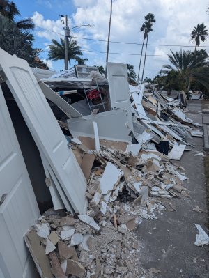

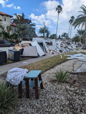

Our contractor is engaged and they are demoing the walls. The water line was 43+ inches. Everyone on Clearwater North Beach was flooded 3-4 feet. Looks like a war zone in the residential areas. It's the same up the western Florida coast from Tampa Bay. I guess we won't be replacing anything until Milton comes through.

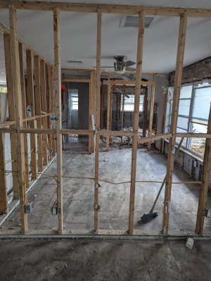

I just got into DIY a few years ago and have never lived in a hurricane/ flood area.. but is the demo necessary?
Can't the wooden structure be dried out and rebuilt upon?
I've seen a few houses remodelled like that.. they keep the foundation, studs and joists but redid the interior and replaced the side panels with bricks.

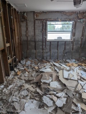

The contractor comes in with a moisture meter and sticks it in the sheetrock wall multiple times while moving up the wall. He does this with multiple walls. When it reaches a certain moisture reading like less than 10% he considers it the waterline and adds 12 in (I believe) because the flood water wicks up the sheetrock. They strip the sheetrock and trim off down to bare studs then bring in dehumidifiers and dryers to dry out the studs. This normally last several days. Then they spray the studs with Antimicrobial and other disinfecting chemicals. When that drys they normally spray some type of sealer. When the environment is ready they install the new sheetrock and trim.
'Demo' in that sense usually means as pictured, stripped to the stud for rebuild.
But you have to remember, this is not a normal flood. This is salt water that can corrode things like nails, screws, anchors that hold walls to the floor, wiring, metal electrical boxes, etc.
Yeah, that salt water is bad news. It's starts rusting bare steel almost immediately.

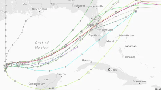

Looks like some spice.
Major impact near Tampa on Wednesday.
Potential track looks wide, maybe it'll verify further from Tampa. Regardless, someone is going to have a bad day.
cone graphic
