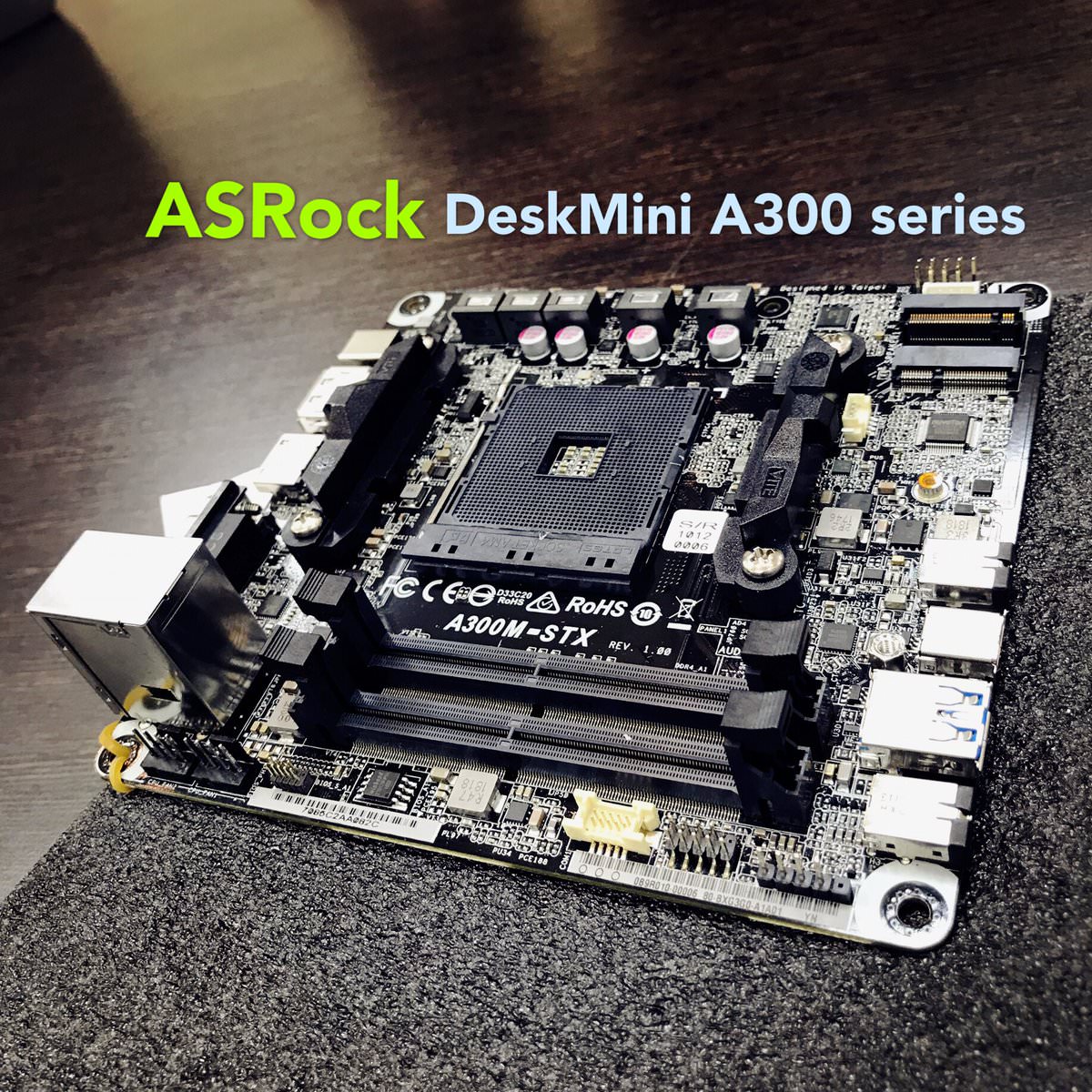

I dont see any chipset so A300 is in fact SOC-Only. I wonder why no OEM attemped to go this route until now, it is strange.
Here is the big version of the board photo that ComputerBase uses in the page header:
Dp93PTnW4AE3t3C.jpg:orig
Note that a lot of STX boards had actual big south bridge on the bottom side. If A300 requires some small "mini chipset", maybe it is some small package more akin to a superIO chip?
I also always thought that AM4 processors could work completely without chipset, but as I said earlier, AMD reps said that X300/A300 are in fact some small chip that still "does something that PCs need". Of course it could have been some mistake. WHo knows, maybe when they said that, they were actually talking about SuperIO itself 🙂
P.S.
Those japanese tweets iirc say something about the board entering testing phase. So it will likely be a few months before it goes to market.
Well it IS strange that no oem decided to go A300, i would have expected brands like Biostar, ECS and Asrock to jump on the A300 wagon right from the begining.
Maybe it needs a chip but AMD reserve them for notebooks or not provide them at all and it needs to be OEM developed.
Has anyone look closer into what all those Zotac box with ryzens?
