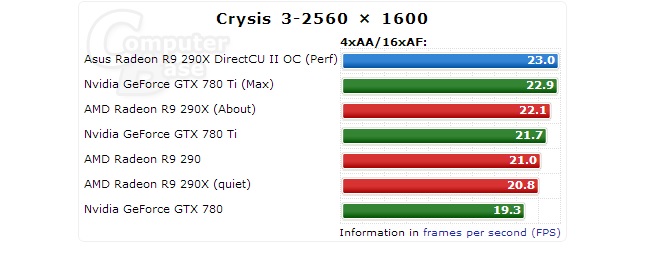

Nvidia advocates should stop posting that HardwareCanucks graphs of Crysis 3, because FXAA is used instead of MSAA, when MSAA is used, this is what you get.
Pretty much moot since that isn't playable really.

Moot? sure it is, because the Nvidia card didnt win.
For me moot is using useless FXAA on 700$ card.
Uh no..... Its because 23 fps is unplayable no matter how you cut it. Useless is paying $700 for 23 fps.
Its like testing igp's at 1080 ultra + 4x MSAA. It doesn't matter if one is 100% faster than the other because 2 vs. 4 fps is completely unplayable.
Highest Playable settings are what matters.
Listen dude, i don't even want to think about play monster game with amazing eye candy and using AA which blurring the image instead of improving.
If one card is faster with max settings, its faster in my book, Crysis 3 is game to be pushed to the limits...at least SMAA 4x they should use, not FXAA.
Point being, 780 ti is not really faster in Crysis 3 then 290X, at least not 10% faster. Most people want to max out Crysis games anyway. So ye, it can't be moot point, never.
Its like saying, GTX680 is almost as good as 780 if you don't use max settings, if you use which card is faster?
In 2 tests, from 3 290X DCII is beating the 780 ti when MSAA is applied, so again which card is faster in Crysis 3?
It's useless if you are running 23fps @ 2560x1440... None of the current High end cards can play it well with MSAA @ 1440p..
3-4 Fps.. who cares.. :rolleyes: Both cards equally suck with MSAA -- 22.9 to 23.0 -- OMG it's faster!! within a margin of error...

It's not useless if you are running 23fps @ 2560x1440... None of the current High end cards can play it well with MSAA @ 1440p.. 3-4 Fps.. who cares.. :rolleyes:
So just because that settings makes the cards crowl, its useless? but hitting 60 fps with disgusting AA mode is great? :D
What about 2XMSAA? 4XSMAA? in those scenarios 290X is getting really close, and with MSAA it beats the 780 ti, so the "780 ti is faster in Crysis 3" is the moot point, not using MSAA.
This is clear win for 780 Ti,
FXAA scenario? not really.
Exactly - What's the point if you are watching a slide show..? Not much looks disgusting @ 1440P ;)
Sounds like Linus Tech Tip testing.. let's make it crawl to show you pretty much... nothing relevant..

It would make sense to test ultra settings with MSAA or SMAA if it were multi card config where its playable. But I agree, slideshow fps aren't meaningful for single cards.
