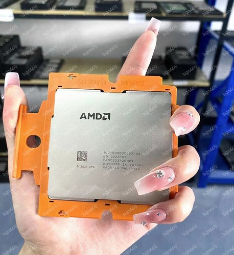

You can get a 32 core QS for under $1000. They are $999 or offer, and they countered for less for me.
