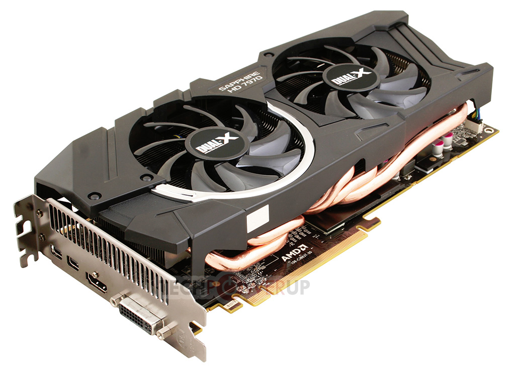

Sapphire DualX 7970 Non-Ghz Edition
GPU1 is a 3 slot design, GPU2 is about 2.5ish.
Originally with GPU1 in PCIE0 and GPU2 in PCIE1, I'd have the issue Blackened described where GPU1 was so big it was basically resting on GPU2. Temps for GPU2 were insanely high, easily hitting 70C+ on full load. The heat from GPU1 was just being dumped all over it. This also caused GPU1 to get high too since the heat from GPU2 was also being sucked into the fans.
So I swamped them. GPU1 is now on my bottom PCIE slot with about an inch clearance between itself and the PSU, and GPU2 is on the top PCIE slot with about an inch between it and GPU1.
