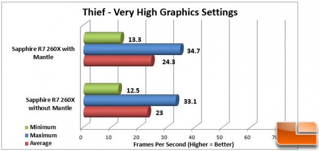

It didnt do anything performance wise for BF4 and Thief. Just adds more points to that AOTS is broken in its current state.
BF4 on PC didn't use async shaders. Thief on Mantle shows big perf increases which may or may not be down to async shaders.
http://wccftech.com/mantle-api-directx-thief-benchmarks-direct3d-creamed/
http://www.legitreviews.com/wp-content/uploads/2014/03/Normal-645x305.jpg
I have to disappoint you. No async shader benefit in Thief. You forgot to post that you picked a CPU limited case with a very weak AMD CPU. No "free performance".
Also we know Thief is broken on GCN 1.2. Is that the future we gonna see?
