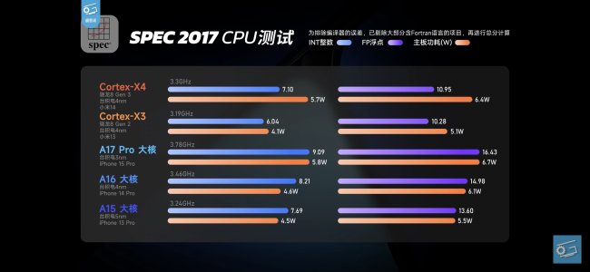

Well now we know why the rumours of a Snapdragon 8 gen 3 with X4 @ 3.7 GHz didn't pan out.
The power consumption is high at 3.3 GHz already.
Reactions: Tlh97 and Saylick
The big power increase vs SD8G2 suggests it was already straddling the optimal position on the frequency curve with X3, while X4 just asks too much of the µArch for minimal gain, especially in on the FP side which seems like a laughably pitiful perf increase for such a large power draw increase.

As these results show, Arm still use ~ 25% more power on a similar process node to lose to an an A16 or A15 by 8-14%.
The X4 is a generic Firestorm core. Matches an M1/A15 roughly on GB5 and close on Spec, albeit 26% more power draw (in the Spec example and probably similar for GB5 with the 8 Gen 3).
What a significant power increase, especially for SPECfp2017: perf / W dropped by 15%. Massive degradation.
Has Geekerwan published a methodology of its power testing?
Translating their legend via Google, "主板功耗 (W)" = "Mainboard power consumption (W)", which if true is decidedly not just CPU power. Is there a chance something else (DRAM, VRM, medium / little cores on background tasks) has eaten up power? I don't believe these are idle-normalized numbers. Geekerwan, unfortunately, does not probe the issue.
Not discounting their results outright: Arm might very well have shipped a very poor floating point design in the X4.
I don't know how AnandTech got its numbers, but losing 1W+ somewhere (either the CPU or the mainboard) for +6% perf looks like a 'failure' in mobile CPU design.
