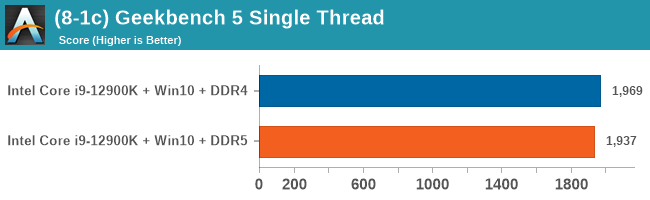

On that note, I did find AnandTech's tests of Geekbench 5 (none on Geekbench 6) with Alder Lake DDR4 vs DDR5, which on 1T shows a very similar (<2%) result, even with +49% copy bandwidth on the DDR5 testbed (individual read/write +69%) vs DDR4.
DDR4-3200 CL22
DDR5-4800B CL40
I believe Geekbench 1T is not very sensitive to bandwidth.
The same should apply to Geekbench 6 (i.e., what Arm's Blackhawk perf claim is based on): identical 5950X system, just 1x8GB (single channel) vs 2x8GB (dual channel): 1T hardly budges, just 2.3% in favor of dual-channel.
Contrast that with web browsing, e.g., Speedometer 2.0 (+18.0%) or GB5 nT (+25.3%):
I was honestly surprised JavaScript tests were sensitive to memory bandwidth with such a notable win for the DDR5 testbed. I don't see that reproduced in other web benchmarks, either: DDR5 scaling or DDR4 vs DDR5.
