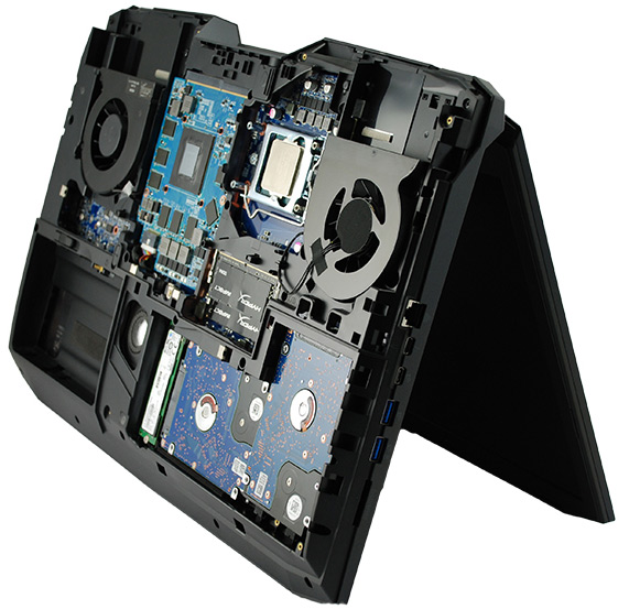

Maybe to increase standardization the laptops could use desktop processors and MXM cards (Some examples below from Eurocom):
https://www.anandtech.com/show/1192...4c-x7c-and-x9c-laptops-with-core-i78700k-cpus
Of course, this means the laptop can't use Thunderbolt III or usb-c for power.

We've always been "at the point" technologically. The problem is that mobile users want thinner/lighter/bigger-brighter-screens/bigger-batteries. Which means as long as there is any "fat" on the form factor, whoever cuts it first and abandons the form factor wins big.
The gaming laptop market, by itself, hasn't been big enough to sustain a standard like that alone. There have been a few attempts at swappable GPU modules over the years, some of which were also used in SFF desktops, like iMacs. But none of them have stuck. You integrate a GPU onto the motherboard and you get your thinner/lighter/smaller laptop, and mobile gamers seem willing to tolerate replacing their entire rigs every 2-3 years. Until that changes, there's zero incentive for manufacturers.
So buy one if you can, and otherwise, grab a beer and fuhgedabowdit.
