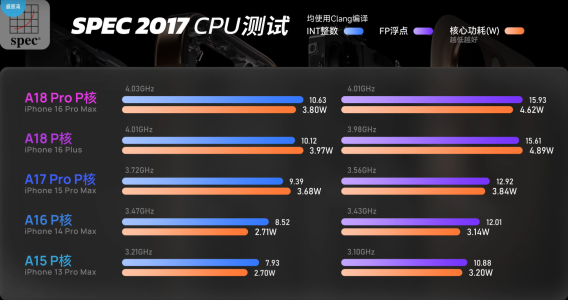

This year, Apple has done a very good job of improving power efficiency.
I'm still of the opinion that the problematic N3B process was the reason for A17P's large increase in power draw. Apple was paying for "known good dies" and TSMC was probably insisting on cranking up the power a bit to include some dies Apple normally tosses (or saves to use in less power sensitive products like Apple TV) to deliver enough dies to meet Apple's needs.
N3E fixed the yield issues, so Apple was able to do their normal binning.

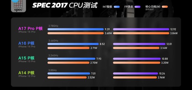

One thing I noticed about this chart, and then the one below is the A17 Pro values are different. I'm assuming just an accidental mix up.
Odd too that the spec2017 results don't go to the max frequency for the A17 Pro in his A18/P review. But in the previous videos he shows the same spec2017 int and fp values for the A17 Pro, but the correct max frequency. I'm assuming another accidental value there. The reason I mention it, is because he points out that the A18P sees a 4.5% IPC increase (integer), but in that other video we see 6.2%. And when the normal 3.78GHz value is used instead of 3.72GHz, the IPC increase shows as 6.1%.
What gives? 😵‍💫
What gives? 😵‍💫
The frequency in the A18 Pro for the A17 Pro might be typo since it’s the exact same results as the A17 Pro review. A lot of typos, I guess it was rushed.
Hopefully for the 8G4 review we get a less error prone graphs.

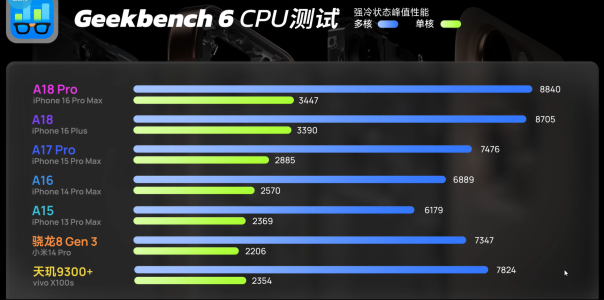

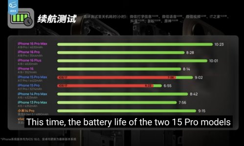

Kinda incredible how iOS18 improves battery life so much.
But the Geekbench scores are also lowered.

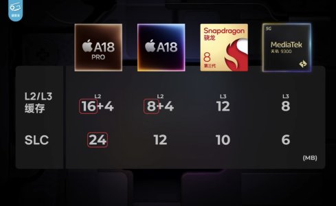

When it comes to A18 Pro, Apple is still outspending Android SoC vendors in terms of cache capacity. But the A18's cache capacity is actually similar to current Android flagship CPUs.
Also something that the Geekerwan review revealed is that the reduced cache doesn't make a huge difference to the performance or efficiency. But there is a difference, yes;

I always ignore the listed frequencies because benchmarks always seem to have a hard time determining the frequency. They aren't actually running at "less" frequency, its just the frequency being calculated/reported that's different.
What stood out to me was the slightly higher power draw of the non-Pro A18s. I wonder if that's just due to the smaller cache (i.e. working the memory controller a little more) or if they're the same die and Apple binned on power draw, using ones that could operate on a bit lower voltage in the Pro models.

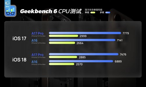

I noticed on one of the Apple OS youTubers I follow that geekbench scores were a bit lower in iOS 18 compared to iOS 17, particularly after iOS 18.0 beta 2-3. So when considering that, those 8100-8200 scores make much more sense, which means ones at 8400+ must just be super good bins and/or ideal cooling conditions.

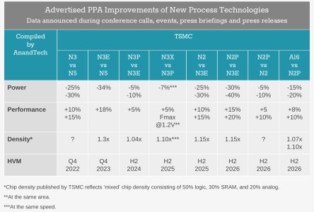

Figured I’d post this since it’s newsy. A19/P on TSMC N3P. A20P on N2.
Should be a good opportunity to upgrade the architecture for the Ecores. It’ll probably be an iteration on the Pcore.
Looks like the release cadence for Apple Silicon will be staggered a year behind HVM.
One thing I’ve personally noticed for my 14 Pro is that in Safari and Firefox my Kraken 1.1 time was faster by about 13% and my Speedometer 3 score was higher by about 6%.
No real reason for iOS 18 to have lower scores other than handling power management or temperature targets more conservatively. Since Geekbench is a peaky load if they changed how quickly it ramps up clock speed or promotes a load from E to P cores that might account for it. If it is temperature target related then you'd see it in all loads.
If this turns out to be a real thing and not just some weird measurement artifact for that one guy, I hope Geekerwan picks up on it and does testing between iOS 17 and 18 to figure out what changed.
He did identify the change in the delay before ramping to full frequency on the P cores in iOS 18. He spends a couple of minutes talking about it before the conclusions closeout of the review. He lists graphs of the frequency ramping, but unless I’m missing something, there are no quantifying numbers on the charts or in his audio. I wanted to see an expression in milliseconds.
He did note that it particularly affects Geekbench subtests that last less than one second.
If this boosting algorithm is applied to macOS 15 then Geekbench scores will be lower their too.
This is well understood. With iOS18 Apple slightly lengthened how long the CPU runs at lower frequencie before it climbs to higher frequencies. Very good for battery life, bad for benchmarks that only take a second or so...
The basic point is that, IF YOU CARE PRIMARILY ABOUT THE USER EXPERIENCE not about winning benchmarks, you're going to keep diddling this curve every year, because "time spent at lower frequencies" should basically be tuned to human response time, which means it's going to grow as the CPU becomes faster (can do more at lower GHz). My guess is that someone at Apple realized this, after a few years of never bothering to tweak the DVFS curve, but maybe now it will be redone with each new CPU?
Also means that if the goal of your benchmark is to test peak performance, you need to do something like run a second or two of warmup code before kicking off the real, timed, code.
Then the objection would be that the warmup code is hurting CPUs that are more aggressive about ramping up clock, because the "warmup" code would do as its name said and make the CPU more likely to throttle later in the benchmark run.
There isn't any way I can see to do this sort of thing and be "fair" to all. All we can do is be aware of the ever growing list of asterisks when comparing different platforms. It used to be so easy in the days when you were mostly testing single core systems that always ran at the same frequency and their only method of "power saving" was the off switch :tearsofjoy:
But hey, now people complaining about Apple's SME boost in GB 6.3 can stop complaining, as they've handed back that boost with iOS 18!
