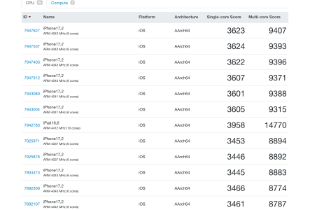

A18 Pro sets a new record in Geekbench6
3600 Single Core / 9300 Multi Core
That phone is running iOS 18.1, it seems like its scoring like iOS 17.7.
Even the A17 Pro scores 3000 now with 18.1, before with 18.0 it can only do 2800.

That 9300 MT score is super high. I wonder the configuration of the phone/chip to get that high. Seems like the normal scores for 18.1 is around 8500 to 8600.
jdubs03
Oct 1, 2013
1,493
1,078
Though to be fair, seems like this poster got a really good sample/+maybe using a freezer. But regardless, it looks like 18.1 gives a 5% boost in single-core and 6% boost in multicore. I wonder if 18.1 reverts the delay to core ramping?
From what I can tell it does look like the 8700 to 8800 scores were from pre-beta 18.1.5 or GA 18.0 where is the above ones are 18.1.5.

The iPad scores in your screenshot are also high. Maybe someone changed the delay for some aspect of iOS 18 development and forgot to change it back for release.
Some Apple employee got to that part of the Geekerwan review and said, “Oops!”
There are other strategies than "have a fixed delayed value before ramping to full speed". Maybe it is smarter about recognizing patterns of demand for bursty loads like GB. Look at all the work as far as recognizing different access patterns for prefetch, and all the optimizations around branch prediction. And those are things where decisions have to be made in a matter of nanoseconds. You have a comparative eternity to make the "right" decision about when to ramp your P cores up and down, switch loads to E cores, and so forth.
We might need to do more measurement than just "time to ramp", and look at the full clock trend over a GB6 run before/after to figure out what it is doing differently (though we won't know why it is doing it differently) and maybe construct some sort of microbenchmark to try to determine what it is doing.
Or maybe @name99 will tell us, if he's read some hints about it in a patent lol
Not yet! But the patents sometimes lag release by two years or more :-(
You are right; this does seem like the sort of thing that could be varied depending on the situation. Meaning it could be subject to a patent -- but when that becomes public???
