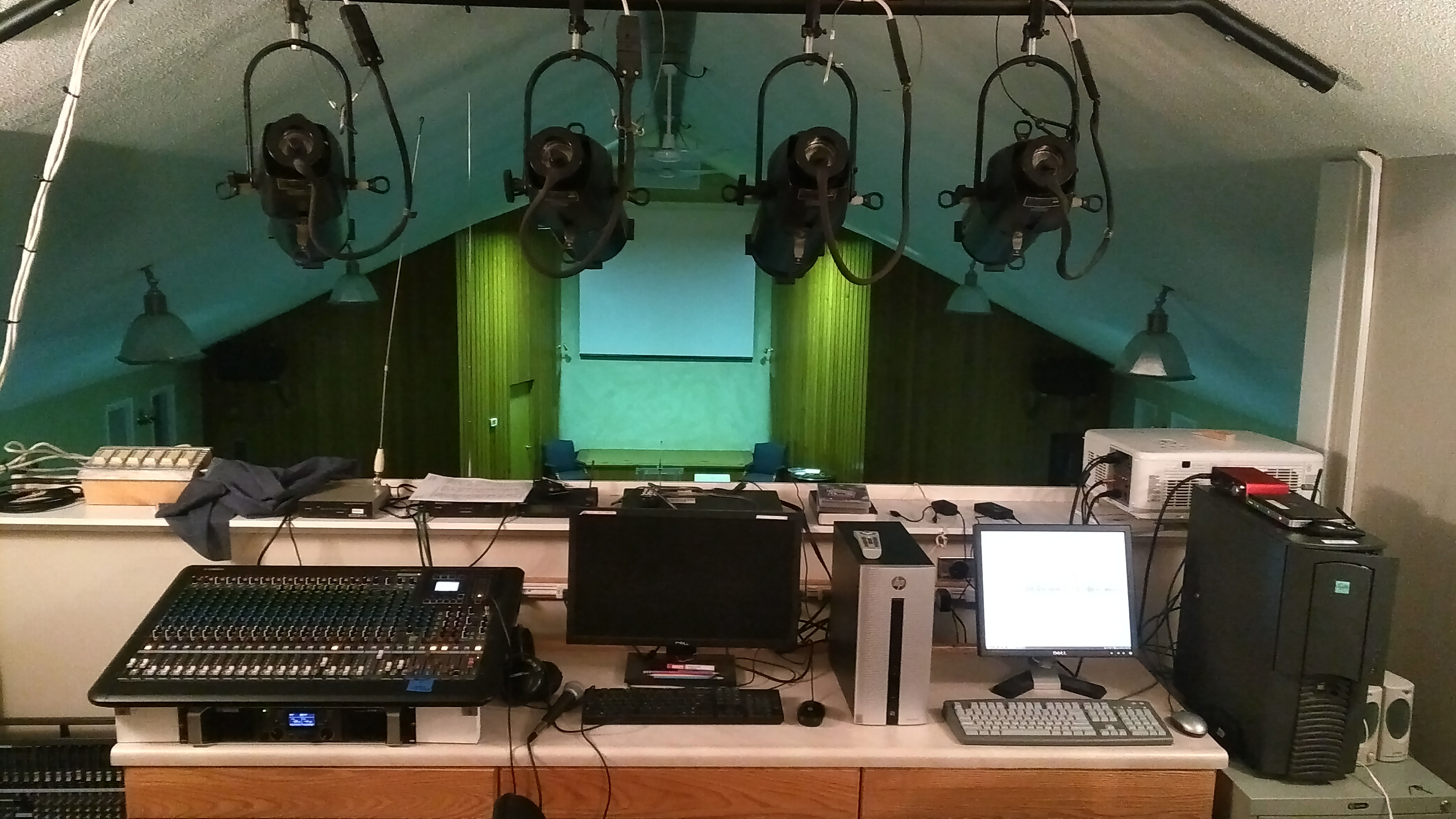

Old pic on the ghetto setup, it's been rearranged a bit since then.
The 47" TV even looks small these days, still use it as an extended screen.
It has held up remarkably well over time, even with some burn in here and there depending on what is thrown at it.

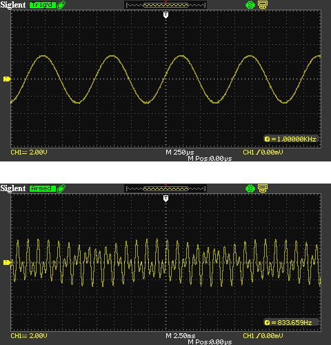

That's a funny looking digital signal. :p
Straight from a built on sound card. First one is a 1khz tone in Audacity, the other is a DTMF tone.
I suppose SOME sound cards might use some kind of PWM output to simulate analog sound, but even then I think I'd still qualify that as analog, it's just an analog signal that happens to look digital. Speakers work analogly, it's just the nature of them. Even POTS is analog, even though the hardware at the end may be digitized. Most computer speakers will have a built in amp as well since the signal from the sound card does not have much power behind it.

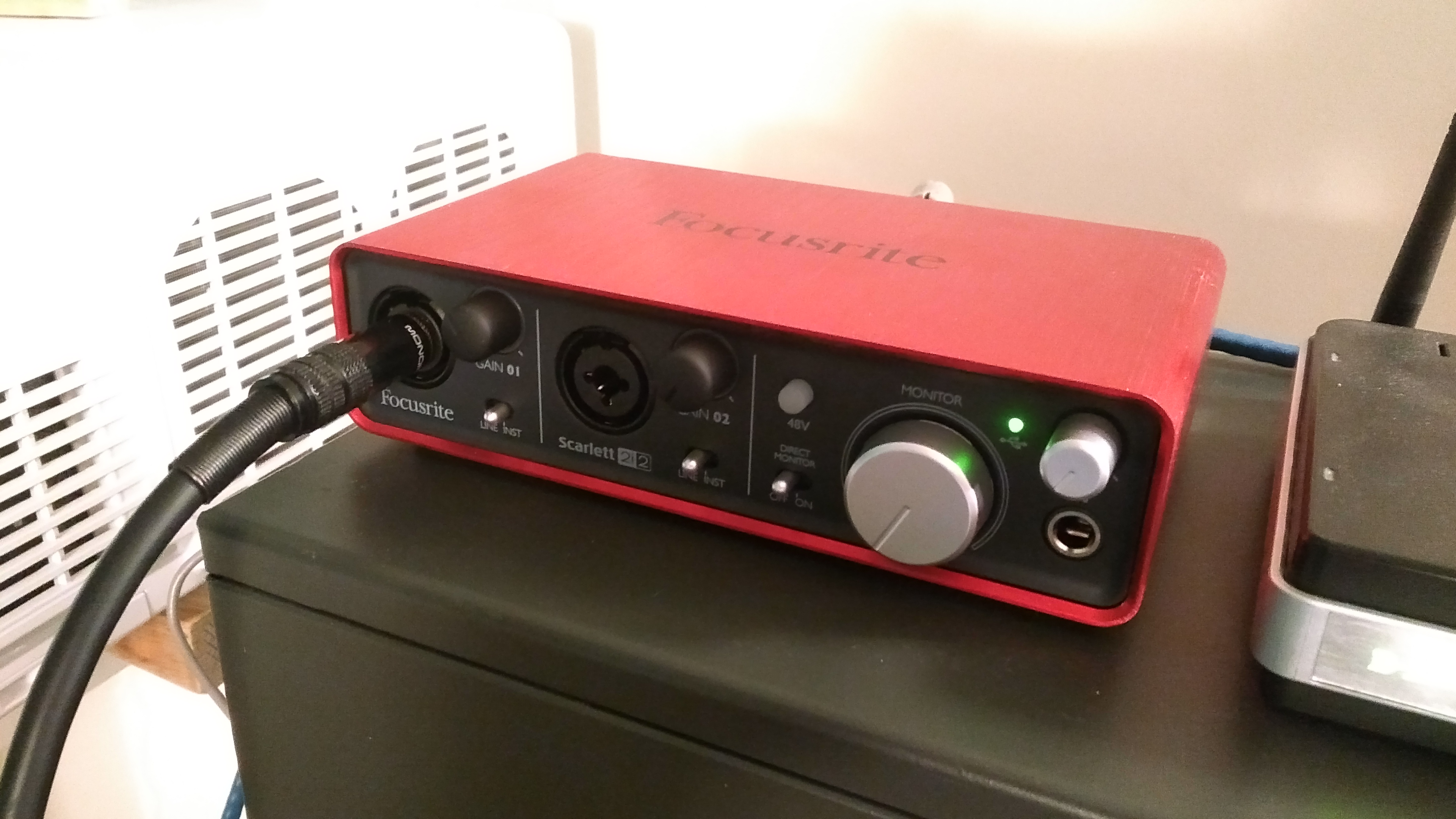

So I setup the Scarlett 2i2 box at church just now, that I talked about in another post. The difference is night and day. This is for recording in my case. On the built on card we were getting lot of noise, which is typical of onboard. Usually it's not a big enough deal if it's only used for playback since whatever you are playing is going to overpower the noise, but for recording it was actually pretty bad on that particular system. We also have some 1000w stage lights and when those were on the dimmer the recording would pickup the 60hz noise. Not anymore.
The Scarlett box is basically a USB sound card and it also uses a proper audio grade cable, so no need to mess with adapters or making custom cables. Just a regular guitar cable. It will also take a XLR cable.
So long story short I did find a use case for a non built on card. But guess it's rather niche. :p
