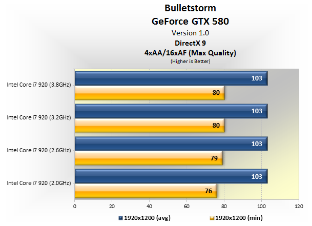

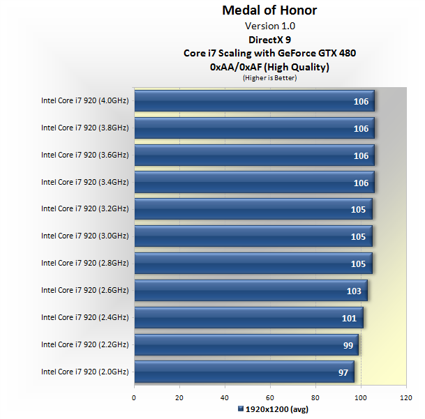

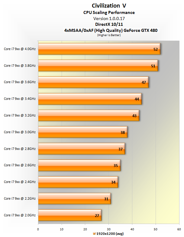

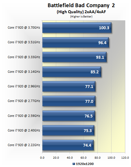

You can check articles like done here at Techspot for cpu scaling.
http://www.techspot.com/reviews-videocards.shtml#gaming
http://www.techspot.com/review/368-bulletstorm-performance/page7.html
