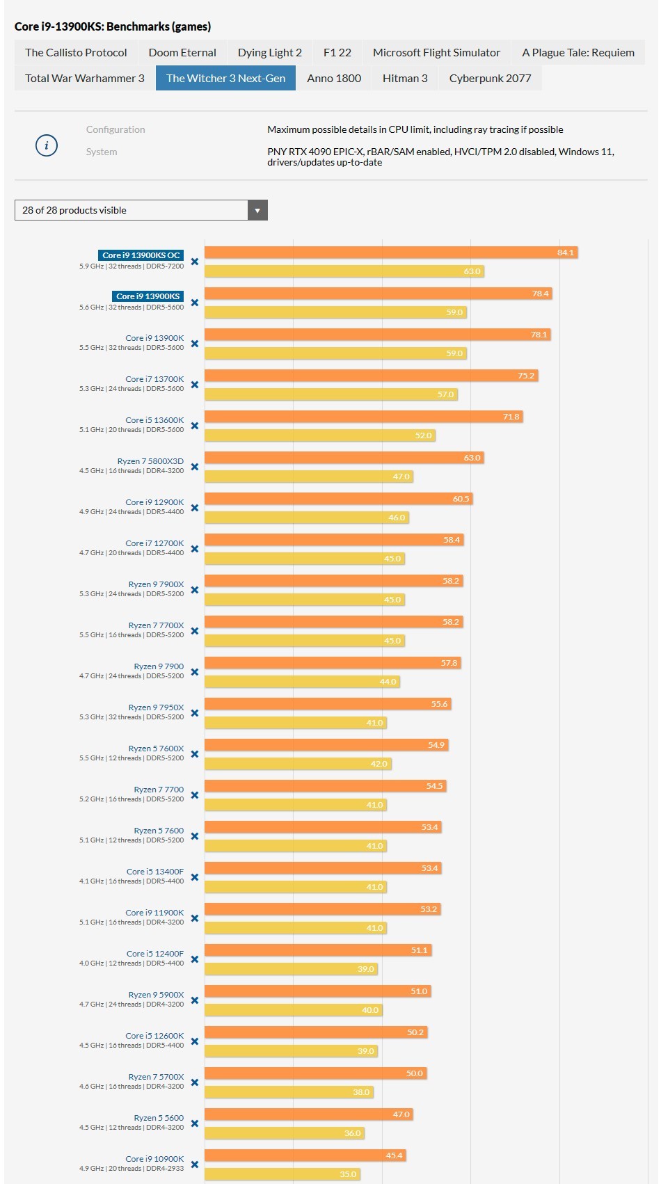

This may surprise you, but because of ray tracing, being CPU limited is much more prevalent now than it has ever been. That HWUB graph has already been heavily critiqued because they never tested any CPU bound scenarios, which is why the graph looks as bunched up as it does.
If you're GPU limited, then the CPU hardly matters at all so why they even bothered with all the testing if it's meaningless in the end? To do proper CPU testing, reviewers need to find the most CPU limited areas in the games and also enable settings like ray tracing which increase CPU dependency. Compare the HWUB graph to something like what PCGH.de does with their testing.
This is a worst case scenario for Zen 4, because The Witcher 3 Next Gen has terrible CPU optimization which makes it hammer 2 cores (due to non native DX12), and when you factor in the BVH calculations from ray tracing and the increased crowd density and draw distances from the next gen enhancements, then it's literally the perfect storm for CPU testing.
Here the 13900K is a good 40% faster than the 7950x at 720p to maximize CPU dependency. Currently, no CPU can maintain 60 FPS in this title at all times and even at 4K you can be CPU bottlenecked.

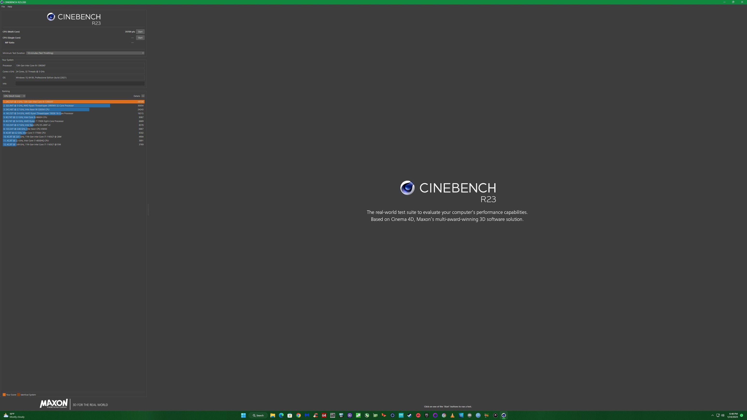

But there is so much room for tweaking and improving with Raptor Lake when it comes to power consumption and thermals. For example, here is a CB23 run at 5.3ghz 235w.
What do the score/temps look like when sustained for 10-30 minutes? Single run CB23 scores can be pretty far from actual sustained performance. Especially if near the thermal limit. The render doesn't take long enough to heat soak the cooler. Nice score regardless. 🙂

Good question. I'll do a 10 minute run and report back. BTW, check the Raptor Lake official thread. Some good info in the last few pages about tweaking DDR5. My memory performance is significantly better now:

10 minute run generated a score of 39,709. I opened the window and let some cool air in though while the test was running. I can't say enough good things about the Fractal Design Torrent and the Noctua NH-U12A. An exceptional combo for air cooled setups.
Utilizing an environmental temperature of 51F/10.5°C to augment your cooling and then claiming "air cooling" is a bit disingenuous.
I might have to see what CB23 score my air cooled 13700k can get if I set it up in my garage the next time we have a below zero day 😉. My single run score is 1000-1500 points higher than my sustained scores depending on how I configure it. Might be because of more aggressive than stock thermal limits. I don't give a crap what AMD/Intel are saying about 95-100c throttling under load being okay now I'm not running my CPU that hot.
That's cheating! 😡
