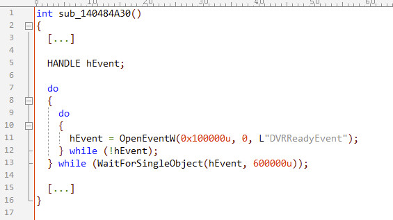

This is shockingly poor quality code, and such garbage needs to be called out.
PITCHFORKS!!! First, it should be fixed. Second, who switches vendors and doesn't uninstall the previous driver package? You always have been and always will be asking for problems by not taking that step. It doesn't matter who the vendor is.

Meh. Yes they should probably fix this but leaving AMD or NV drivers on your system when you switch to the other is just asking for trouble. The real solution is remove the AMD driver when you switch to an NV card.
Still, it's just REALLY bad code. Even if you did want to have something that would potentially wait forever, there are better ways of handling it.

The problem is more what it says about the rest of the code and the general qa/code review process that is being used to verify it. That said if you could look behind the scenes at a lot of companies code you would probably be appalled.
It's easy to understand how something like that gets through because all of the automated tests that would be run would likely only be done on a test system without this particular problem. It's pretty unlikely to misbehave in the same way that would set off flags in the test system.
It is the kind of code that's good enough for the Underhanded C Contest because it's easy to overlook, easy to attribute to incompetence or a mistake, but actually has some nasty effects and might make people think it's a problem with their competitor's product. But given some of the cowboys that work in the industry I'm sure it's better to attribute it to stupidity as opposed to malice.
Exactly and code like this doesn't shine a good light on their software engineering practices. If the driver itself is similar badly made, stability and security issues are certain to exists and probably also leaving performance on the table.

First, this has nothing to do with their drivers, as this isn't a driver file.
This is one of the user space programs that gets loaded with the AMD suite. It is a rather poorly thought out piece of code. A do/while loop will just sit there spinning without any sort of wait state, which is why its consuming all of one core. Just adding a 5 second sleep would fix the issue. Or make it event driven, and ditch the loop entirely.
Is it a dumb thing to release? Sure.
Is it some horrible "OMG worst drivers ever" issue, no.
I'll bet your system right now has half a dozen drivers for devices not currently connected. You don't know because Windows installed them automatically in the past. Do you expect to have six pegged CPU cores until you manually intervene?
I haven't plugged in my iPod for weeks. Should I be expected to constantly uninstall iTunes, only installing it for the session I have it plugged it?
How about cellphones, USB flash drives, portable HDDs and printers that aren't connected? Is the user expected to uninstall any such drivers when not using them?
Also should I uninstall my Realtek NIC driver every time I disable it?
The fact that this garbage piece of code falls into an infinite loop when it can't detect hardware is AMD's problem, not the user's. Instead of claiming "user error", this pile of coding excrement needs to be called out so AMD fix it.
First, the AMD issue isn't with the driver. It's with software included in the package. How do you not know the difference when its clearly explained in the article? The title was nothing more than click-bait for ignorant hand wavers.
I actually remove drivers for devices that are no longer part of my system. Windows doesn't install them because I have automatic driver updates disabled. No because I actually monitor my system for abnormalities.
Jesus. You clearly don't know the technical difference between a device driver for a GPU and usb devices. Hint, they don't work the same. USB devices do not need a specific device driver because they conform to the USB spec and the OS provides the functionality. You only need an instalable driver to add more features beyond transport and power delivery USB has built-in.
