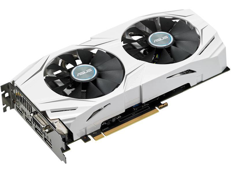

OK, so I think I have my component list down. I'm going for a wintery-type theme with this.
AMD Ryzen 1600
MSI B350 Tomahawk Artic
16gb (8x2) Geil Super Luce (white w/blue LED) ddr4-3000
Asus GTX1060 Dual 6gb
WD Blue m.2 500gb SSD
Seasonic M12II 750 full modular
Corsair 460x RGB
Around $1200, and should be perfect for 1080p gaming. Hopefully I can get around $800 for my current laptop, so I won't be in the hole the full $1200.

Ryzen + amd gpu is a safer bet
He specifically wants a white-colored video card to match his theme. The Asus Dual series for Radeon are pretty crappy/poor QA so in this instance, the 1060 is the safer bet.
If he didn't care about color it'd be very difficult to beat a deal on a RX470 or RX480, however.
Poor QA hasnt translated into bad reviews, though, for ASUS' RX480. I'd risk it.
https://www.newegg.com/Product/Product.aspx?Item=N82E16814126135
AMD Ryzen 1600
Corsair 460x RGB
I'll second or third the recommendation for a 480. It seems like the safer bet and with Freesync and a Ryzen chip you'll have the smoothest gaming experience at 1080 that you could ever have.
