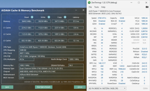

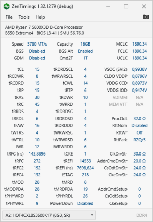

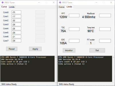

The exact settings may vary depending on the cooling and what motherboard you have (see my post above), but anyway, these I've been using for half a year now (screenshots).
Not shown:
- Vdimm 1.488 -1.500V (1,45V for the 2x8Gb config)
- LLC Soc - "strong" to keep Vdroop within ± 0.5% (fits asrock/gb vrms, for msi/asus I'd go "medium")
- OS : Win 22H2 19045.3570, Secure Boot - off, TPM - off, SVM - off

BCLK overclocking is FAFO territory IMO
If you don't have SATA devices, it either works or not
Degrading or breaking my CPU over inconsequential performance uplift ain't my bag.
You can't degrade it (unless your MB is broken) because OC mode is disabled on X3D parts and Vmax is hard-limited to 1.3V
Speaking of BCLK, unlike OC mode, where V and F are set manually, Ref.Clock OC has essentially the same effect as lowering "CO All-Cores"
