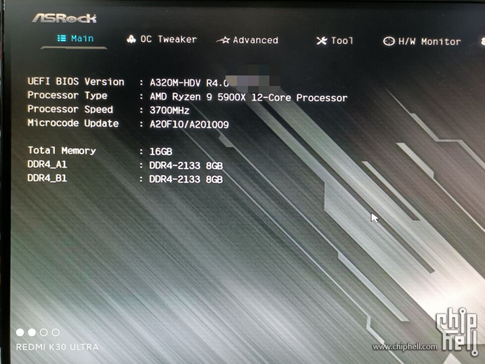

AMD Ryzen 5000 Processors Allegedly Work With 300 Series Motherboards
Asrock A320M-HDV R4.0 Zen3 Beta BIOS download: (access password:7v5w)
alternative download:
theoretically support Renoir APUs, but no one try it yet. This is a beta bios so use at your own risk!!!
