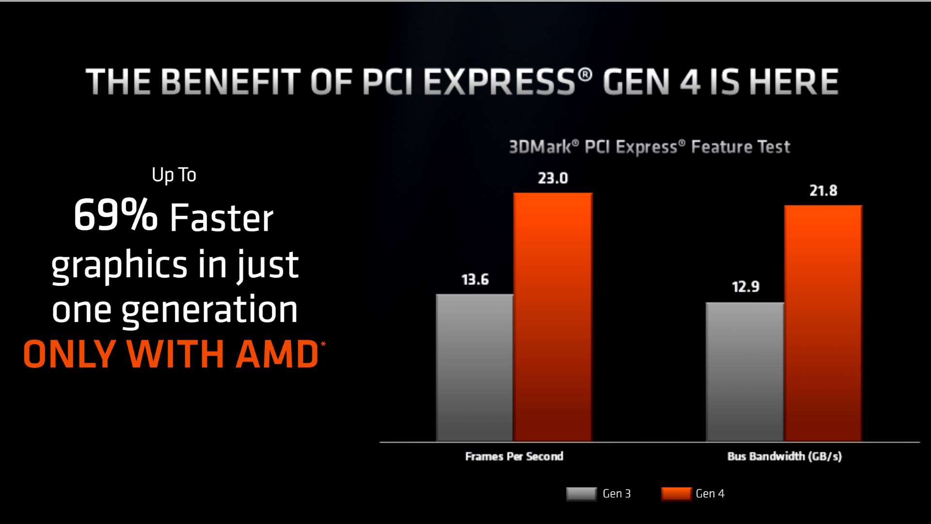

I'm doubting the Crosshair VI really supports PCIe 4.0 as shown in GPU-Z. Is there really anyway to test it?
Unless you are running a beta UEFI, it probably doesn't. I think 3DMark has a PCIe bandwidth test for video cards now.
Kenmitch
Oct 10, 1999
8,505
2,250
It's the latest uEFI from Asus I guess it's technically a beta version, but it looks to be working good so far.
I just ran that 3DMark PCIe bandwidth test, but how do you know what's good? Usually they have a better than ??% I thought.
http://www.3dmark.com/pcie/26995

Hitman928
Apr 15, 2012
6,755
12,501
Looks like what AMD showed as PCIE4 performance:
