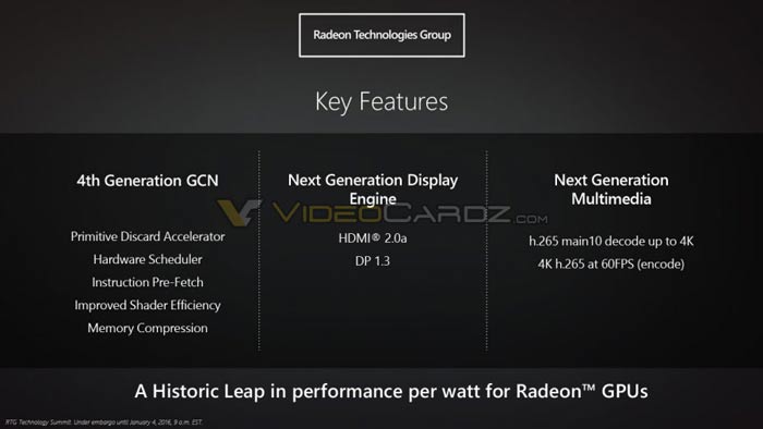

No details on the video encode/decode part?
They were in previous slides that were leaked
https://youtu.be/5g3eQejGJ_A also talks about it a bit
