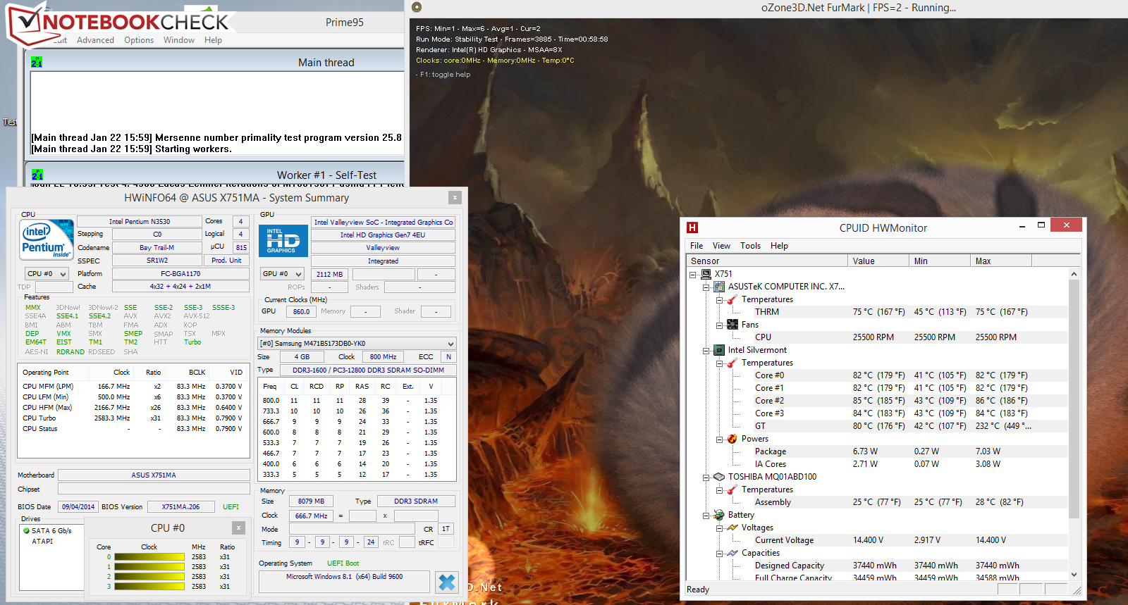

Lol, Furmark say that the GPU is at 0hz..
Indeed let s compare thoses pics from Notebbokcheck and see where they are convenient with some manufacturer :
Let s start with AMD, i took the pic above :
And now with Intel N3530 :
Noticed.?.
The task bar has disappeared, we no more know since how much time P95 is running, they even masked its window, Furmark say that the GPU is, or was, running since one hour, at 0hz and with no %age of utilisation when the screen was "captured"....
At thoses conditions, and the pushed TDP, it can run at thoses settings...

I have a lot of trouble understand the exact meaning of your replies. Are you typing into google translate or something?
This say that the 3530 is pushed way above 7.5W as its CB 11.5 score point to more than 2.4GHz on MT, indeed the pics you linked show a GPU that is 100% throttled and that the CPU can get the full, inflated, TDP headroom.
I can't follow this. Where is the GPU 100% throttled?
Anyway. BT has terrible driver support and stuff isn't reported properly on GPU-Z and other utilities.
As far as NBC, different reviewers use slightly different testing setups. Cue the different Furmark settings/versions or HWinfo vs. Hwmonitor.
OK, you are just trolling, i got it now.

Interesting: CPU is throttling, but it's not frequency related and temps are fine.
At 17:31 thread usage goes down fast and system power usage goes from 25-28W to 18-20W, and stays that way for the remainder of the test.
Does the unit get the same score while plugged in? What Power Plan are you using?
monstercameron
Feb 12, 2013
3,818
the test was on the high performance plan not plugged in.
