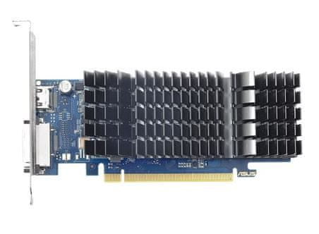

In today GPU market+bitcoin mining madness, Renoir/Cezanne iGPU performance can not be overlooked.Renoir/Cezanne Price=CPU+iGPU performance, who cares about lower CPU gaming performanse with dedicated GPU.Most people don't care for PCI-express 4.0 either, or PCIe Express 3.0 is more the enough.Here is example, current prices in my country Renoir vs Ryzen 3000 Desktop.
Ryzen 5 3600
- local currency in dolars 270$ box version, tray version 260$
Ryzen 5 Pro 4650G
- local currency in dolars 240$
- iGPU performanse similar to GT 1030
- Renoir/Cezanne it is easier to cool and consumes less energy
Dedicated GT 1030 as new, lowest local retail price is 95$.
