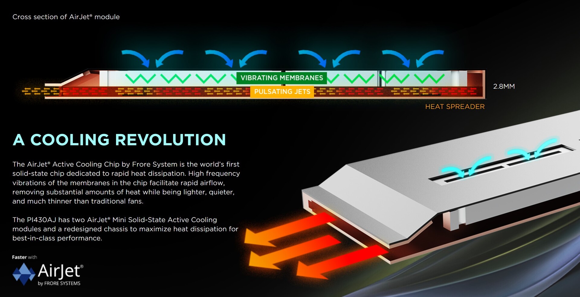

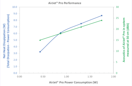

KEY POINT: The AirJet Pro offers 2x the cooling of the AirJet Mini, while consuming less than 2x the power and taking up less than 2x the size.
It does increase in weight by more than 2x the OG Mini though, and about 2.75x the weight of the newer, lighter Mini Slim variant, unless they are also going for a slim variant of the Pro SKU too.

For laptops and other battery-powered rives, I agree the power usage is a tad high.
For Frore's vapour chamber suggestions, the AirJet's low duty cycle power draw is not ideal. It's tough to beat 0mW of a fan that's turned off.
In traditional laptops, the fans turn off and the SoC is passively cooled by the heatsinks and some little baseline airflow. That doesn't quite work with just a vapour chamber (zero heat dissipation) alone, so the AirJets need to be constantly on, no?
1W for the AirJet minimum to cool 6.5W feels a tad high for any smaller battery-powered devices when some heatsinks can cool 6.5W for no power draw. I guess heatsinks still required, which again bumps the cost.
Looking at peak power consumption of the XPS 13's cooling, it has 2x fans, each consuming up to 2.5W, so at peak, it's 5W. The problem is when the laptop is running passively: the "area under the curve" for Frore no longer looks that good.
Having some heatsink + AirJet combination would be great. I'm imagining a tower desktop CPU cooler, but each heatsink fin is cooled by its own AirJet. Sure, it might need a SATA power connector at that point, lol, but at least we'd solve the boundary layer issue that current heatsinks struggle with.
250W heat dissipation = 29 AirJet Pros = 50.75W peak power draw of 29x AirJet Pros. So 1x SATA connector is just enough. Now, the sound of 29 AirJet Pros: would love to see how that compared vs 2x 140mm fans.
Ironically, for all its size benefits, the power draw at lower loads might mean this 1st gen has a more direct path to wall-powered systems.
EDIT: 6.5W is more accurate for 1W of the AirJet Pro. Read that chart a bit too fast.

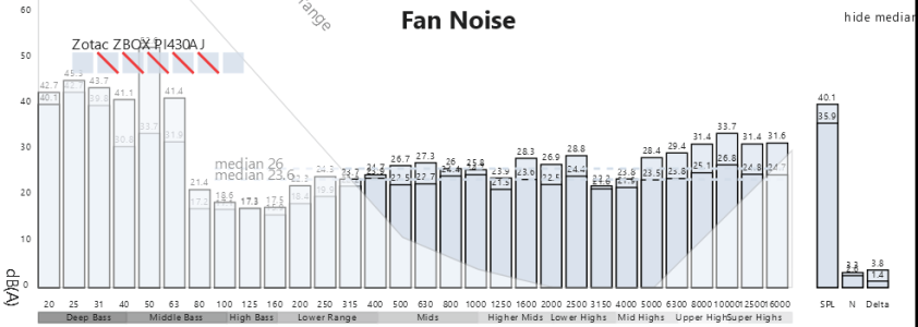

First review up of a mini PC. 2x AirJet Minis, so 9.5W total peak cooling capacity (NBC erroneously uses 10.5W, which is the total dissipation without subtracting its own heat output).
The system, however, doesn't operate in complete silence, as indicated by our measurement results. At idle, the volume level is a very low approximately 26.6 dB(A). With moderate load, the noise level increases to 29.4 dB(A). It's important to note a peak noise level slightly exceeding 40 dB(A). Additionally, the subjective perception of volume may seem somewhat louder due to the high-frequency cooling noise.
Load average is a fair bit lower than other miniPCs, but unsure what happened with that much louder peak.
Power: could just be the SoC / platform or even the power adapter, as it matches the average power draw but compares less favourably to NBC's systems.
I don't use miniPCs enough to judge how good / bad it is, but will read more carefully later.

95°C CPU temp for about 7W power...
Is that a cooler or a heater.?..

Most of the reason I’ve been so skeptical is that they keep publishing these “heat dissipation rates” instead of publishing what is the industry standard for heatsinks: thermal resistance with units of K/W
They've been doing this for noise too if you think about it. Not only are they not silent at max speed, they have a different frequency profile to what we're used to with good quality fans, with emphasis on Mid and Upper Highs (5Khz and above).
I think the tech needs more time in the oven, right now it's more of a niche solution for scenarios where it can leverage it's high static pressure and unique form factor.
I don't see it screaming at 10kHz in consumer devices, unless used below their max rating (and thus with even lower cooling power).
