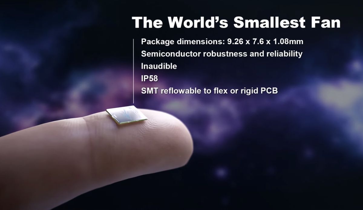

Looks like Frore has attracted some competition from the MEMS speaker crowd....
Smartphones? They'd need to have places for air to enter and exit to make it actually cool the device, and I can't see that being viable.
The openings would have to be pretty small for the surface tension of water to keep it out. but such a small opening isn't going to allow for enough airflow to any real amount of cooling. Who's going to redesign a phone to get it 0.5C cooler?
Plus it's liable to get clogged up pretty easily. Lightning ports get a lot of lint if you keep your phone in your pocket often - it is amazing how much lint you can pull out of there if you dig in with a pin. Those much tinier air inlets would clog up with pocket lint before long, then those MEMs fans are useless. Dust is often statically charged so it'll get in there and stick even with an exit available. Or worse, if you were around some conductive dust (fine metal dust from an angle grinder perhaps) who knows what that does to your phone?
This is a stupid idea, at least as far as smartphones and tablets go.
dullard
May 21, 2001
25,479
3,976
For reference, it is IP-58 rated for dust and water ingress. https://en.wikipedia.org/wiki/IP_code
  • First digit 5: "Ingress of dust is not entirely prevented, but it must not enter in sufficient quantity to interfere with the safe operation of the equipment."
  • Second digit 8: "The equipment is suitable for continuous immersion in water under conditions which the manufacturer shall specify. However, with certain types of equipment, it can mean that water can enter but only so that it produces no harmful effects."
Quick back-of-the-napkin calculation, 39 cc/s of air would cool maybe 0.3 W of power. The actual cooling depends on a lot like chip temperature, heat transfer coefficient, and venting design. But, that is a rough number. Since a SOC may use ~1 W, it could drop temperature rise by 1/3rd. Maybe up to 5°C cooler in the extreme cases. More likely 2°C to 3°C in more practical use cases.
