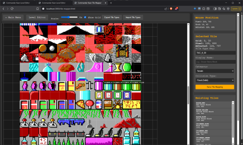

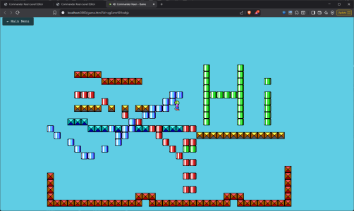

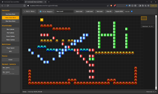

I had a Commander Keen project from a couple years ago. I set up Pocketbase and had Claude make a tile mapper tool and a level editor. It saves the levels to the database so you can share them. I had it implement the tile palette, minimap, undo/redo an eyedropper to choose a tile and a bunch of other stuff, it is pretty neat. The tilemapper saves a lot of time as I can dynamically choose tiles and save them to the database as well. It saves the tile names and sprite sheet x & y coords. I can redefine any tile and save it, then test a level again and the change will be there because the game loads the tiles from the db each time you run it.
